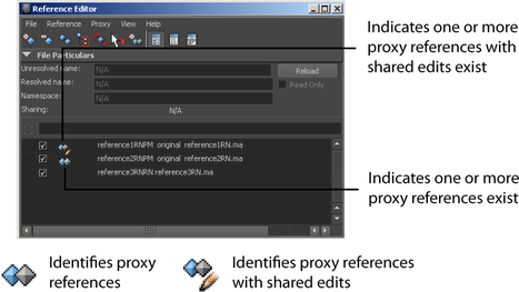

When a proxy set is created with shared edits, the original reference becomes a proxy reference within the new proxy set. In the Reference Editor, an icon is displayed to indicate the existence of one or more proxies for the reference, and to indicate that all proxies share a common set of edits.
