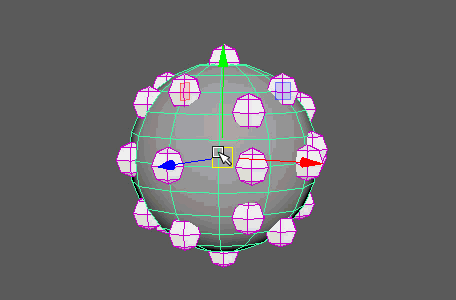

Closest point on Mesh
The following options only have an effect when Mode is set to Closest Point On Mesh.
- Input Mesh
- Displays the current mesh being used as input. You can assign the currently selected object either by middle-dragging it to this field or by right-clicking the field and clicking Connect.
- Closest Point Mode
- Closest Point on Mesh moves all points in the network to the closest point on the Input Mesh. Ray Cast shoots a ray from each point in the Ray Direction, then moves the point to the spot on the Input Mesh where it intersects (if one exists).
- Ray Direction
- Closest Point Mode is set to Ray Cast.
- Hide on Ray Miss
- Hides points whose rays miss the Input Mesh. Useful for turning off objects that fall off the mesh.
