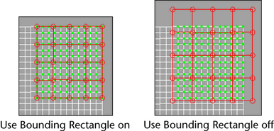

Use Bounding Rectangle
When on, the current lattice manipulator cannot extend past the outer edge or boundary of the target geometry.
