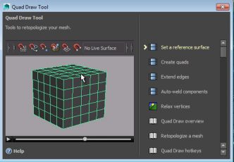

ToolClips provide easy access to learning content via short video clips accessed through the Maya interface. All you have to do is move the mouse over any button or icon that activates a tool.
They demonstrate specific tool functions, such as for tools in the Modeling Toolkit. For example, click to display the Modeling Toolkit, then move the mouse over any of the Tools buttons, such as .
The Quad Draw ToolClip window appears.
Click More to expand the Quad Draw ToolClip to show further detail, such as short video clips, images, and links to related topics in the Help.
