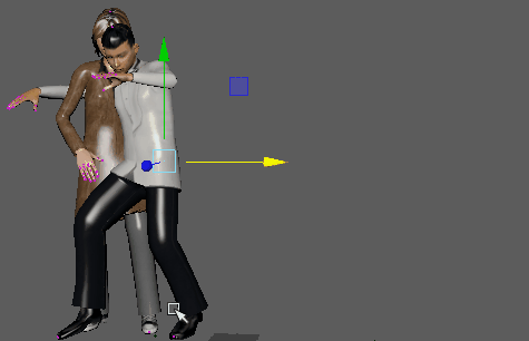

- With the animation clip still selected, select from the Time Editor Menu bar.
- Use the translation and rotation tools, or modify the X or Y values in the Channel box to move your character to a different spot.
