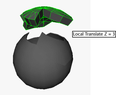

Change the extrusion value of a shard
Once you’ve created a shatter with an extrusion, you can change the extrusion value for all the shards or for individual shards using the Local Translate Z attribute of the shard shape.
If you haven’t created the shatter using an extrusion, an extrusion node is not connected to the shards.
To change the extrusion value of a shard
  1. Select the shard.
  2. If the shard is a rigid body or a shape, In the Channel Box, select shardShape#.
  3. In the Channel Box under INPUTS, select polyExtrudeFacet#.
  4. Scroll down in the Channel Box to locate the Local Translate Z attribute.
  5. Enter a value to change the extrusion.
