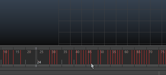

Cutting keys on the Time Slider using the Marking menu
To cut keys
- To select a key, do one of the following:
- To select a
single key,
Shift-click the key in the
Time Slider.
The Current Time Indicator moves to the clicked position and the key is now selected and highlighted in blue.
- To select
multiple keys,
Shift-drag over the range of keys in the
Time Slider.
The range of keys is now selected and highlighted in blue.
- To select a
single key,
Time Slider.
- To cut the key(s):
- Right-click and select Cut from the menu that appears.
- Select
Cut in the
Key menu.
If Time Range-All is on in the Cut Keys options, all keys for the current object are cut. If Time Range-Start/End is on in the Cut Key options, only keys between the specified Start and End time are cut. If Time Range-Time Slider is on in the Cut Keys options, only the keys between the Range Slider’s Start and End times are cut.
- Click in the Viewport, and press Shift + s to open a marking menu. Select Key >Cut Keys.
