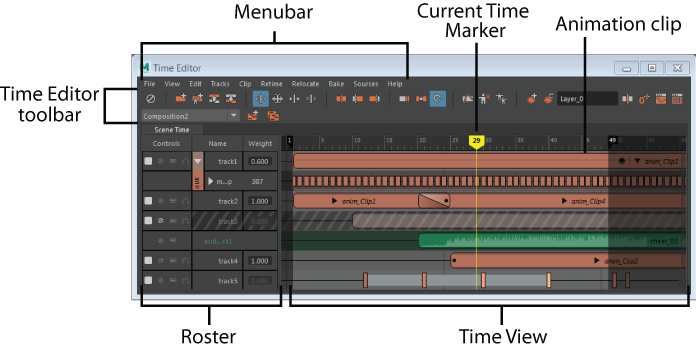

    The Time Editor window includes a Roster and the Time view.
  • The Roster on the left hand side represents the timing hierarchy of objects.
  • The Time view on the right hand side contains clips.
The Time Editor is designed to let you set up animation flows and then fine-tune the keyframes in the Graph Editor. Click the Open the Graph Editor icon () on the menu bar to display the Graph Editor window. To switch back to the Time Editor, click the Open the Time Editor icon () from the Graph Editor menu bar.
Many Time Editor basic operations are available only through contextual menus that appear when you right-click different areas and objects. See Time Editor contextual menu.

Time Editor Menu Bar
The Time Editor menu bar contains options to organize and view your compositions. See Time Editor menus.
Time Editor toolbar
The Time Editor toolbar contains options that are also found in the menus and by right-clicking the Time Editor Interface. For descriptions of what these icons do, see Time Editor toolbar.
Time Editor Roster
The Roster, located at the left side of the Time Editor is where you can find the Time Editor controls, such as Mute, Solo, Ghost and track Weighting. See Time Editor Roster and Key Time Editor clip weights for descriptions of these features.
Time View
Next to the Roster, the Time View contains animation clips on tracks. Each clip is associated with an group, an object, or an attribute of the object. Use the scrollbar to view all animation clips in the time view. See Time Editor Time View for more information.

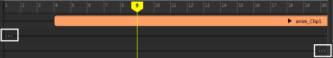

Whenever you select a clip, the start and end frame appears above the clip.
If a clip exists outside of the time editor window, a dot appear at the end frame to indicate there are clip(s) outside the boundary.
