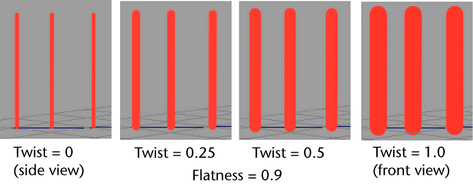

When tubes have some flatness or texture (see Flatness 1 and Flatness 2 settings in the Brush Profile settings), you can twist them to produce effects like a twisted ribbon.
Twist
Tubes can twist around their own axes as they grow. The Twist attribute defines the initial twist value. Twist is only noticeable when the tubes have some flatness or texture (Flatness1 and Flatness2 values are greater than 0). See also the Twist Rate section below.
