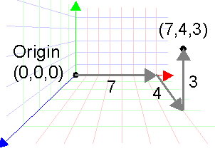

To determine the location of points, we first establish an arbitrary point in space as the origin.
We can then say a point’s location is so many units left (or right) of the origin, so many units up (or down) from the origin, and so many units higher (or lower) than the origin.
These three numbers give us the 3D coordinates of the point in space. For example, a point 7 units right (x), 4 units down (z), and 3 units above (y) the origin has the XYZ coordinates (7,4,3).
To specify points on the opposite side of the origin, we use negative numbers. For example, a point at (-5, -2, -1) would be 5 units left of the origin, 2 units up, and 1 unit below.
