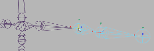

To manually orient a joint’s local axes
- Select the joint whose local rotation axes orientation you want to set.
- Select
Display > Transform Display > Local Rotation Axes.
The current joint’s local rotation axes appear.

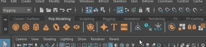

- Click
Select by Component Type
in the Status line (toolbar) to turn on the Select by component type mode, then right-click the Select Miscellaneous components
icon and turn on Local Rotation Axes.
Note: Select by Component Type must be active for the Select Miscellaneous components icon to appear.You can now select the local rotation axis of your joint.
- Select the local axis.
- Do one of the following:
- Select and use the Rotate Tool (hotkey: E) from the Tool Box.
- If you want to enter precise orientation values for the local axis, you can use a MEL command like the following:
rotate -r -os 180 0 0;
This command rotates the current joint’s local axes 180 degrees about its X-axis.
