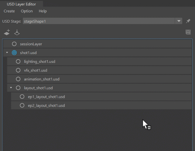

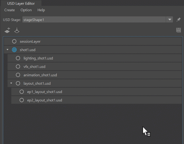

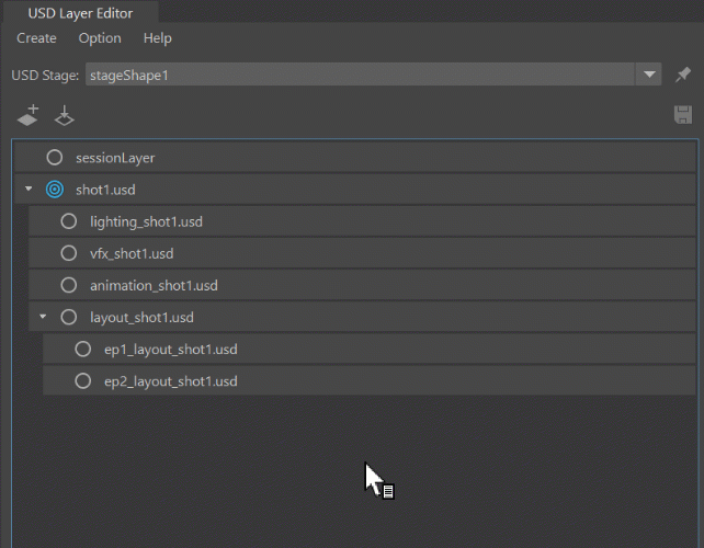

To move a single sublayer, click and hold to drag and drop the layer into a new location. To move multiple layers, use shift or control to select multiple layers to drag and drop.
The following happens when you drag a layer:
When dragged on top of another layer, a white box appears indicating that the layer will become a child of this layer.
When dragged above or below another layer, a white line appears indicating that the layer will become a sibling of the other layers.
