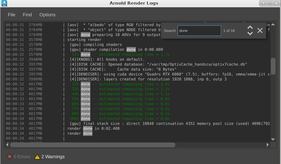

  • Improved Log Window in Render View: The log window for Arnold Render view has been enhanced with a new search bar and color highlighting (ARNOLD-212)

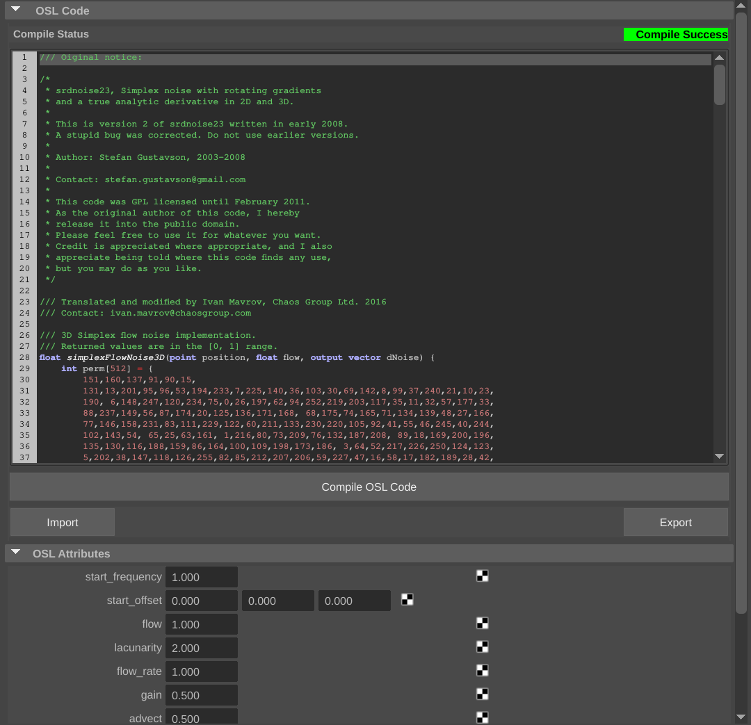

  • Improved OSL Code Editor behaviour: the OSl editor for the aiOSL node has been improved to allow better felxibility when editing code. It no long re-compiles after each edit and will allow the user to save work-in-progress code. (MTOA-1152)

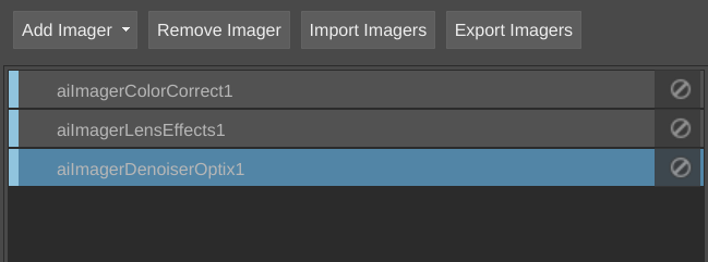

  • Add support for Export and Import of imager graphs: The imager editor in ARV and the Render Settings now support the import and export of imagers as .usd or .ass files for sharing with other scnes or other Arnold plugins. (MTOA-1167)

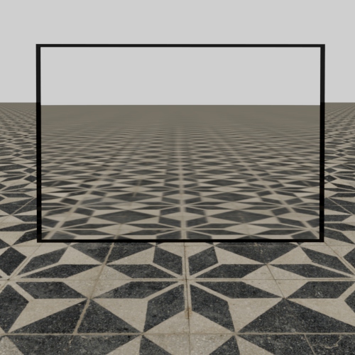

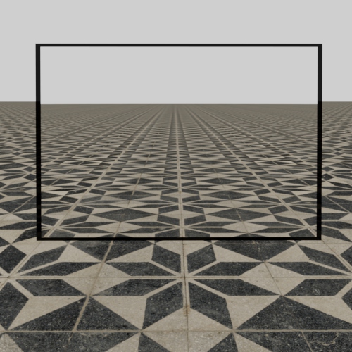

  • Sharp textures through reflections and refractions: Textures seen through specular reflections and refractions, particularly when there is low roughness, such as with clear windows and mirrors should now look correctly sharper. This can result in higher resolution texture mipmap levels being loaded in memory, so scenes that were affected by this can see an increase in texture cache usage. (ARNOLD-5632)
