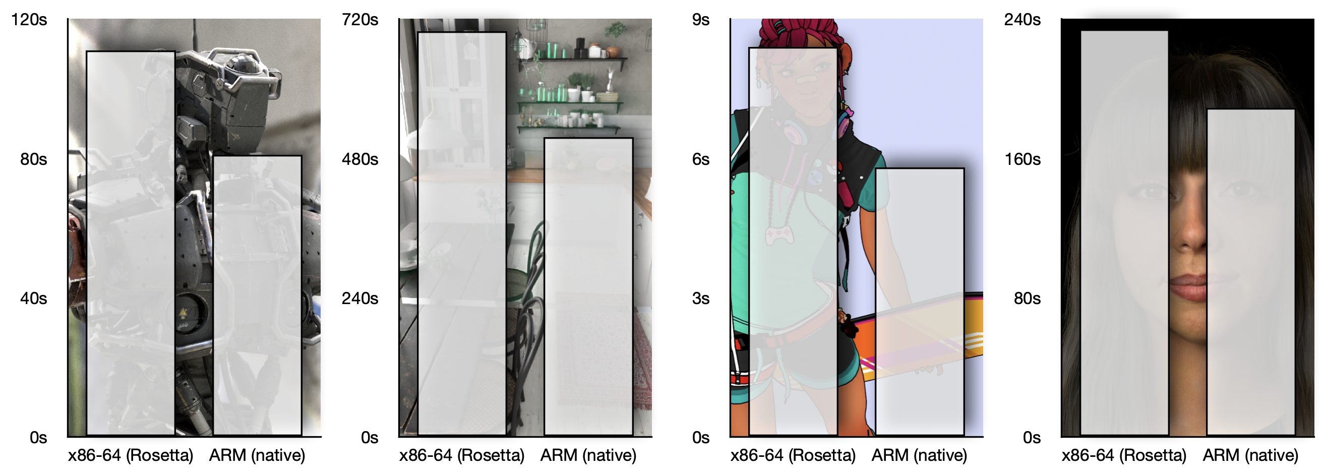

  • Apple Silicon Support : Mtoa now supports Apple M1 chips for Maya 2024. In our tests, running natively on Apple M1 chips can give speedups of up to 1.45x compared to running with x86_64 Rosetta 2 translation. (MTOA-976)
