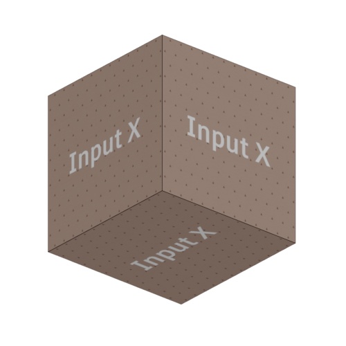

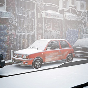

- Per axis texture in triplanar: The triplanar shader can now optionally use different textures for each axis. ARNOLD-11708.
| input_per_axis: disabled (default) | input_per_axis: enabled |
A wide range of shading effects such as snow, dust, sand, and moss, can be achieved using input_per_axis (Y).
Rollover images to view with and without triplanar.input_per_axis (Y)
