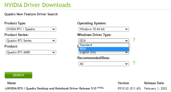

  • We recommend using the 511.09 (Quadro), 511.09 (GeForce) , or higher on Windows and 495.46 or higher drivers on Linux . See Arnold GPU for more information.
  • The driver type must be set to DCH.
I n the driver page select "Windows Driver Type:" DCH
