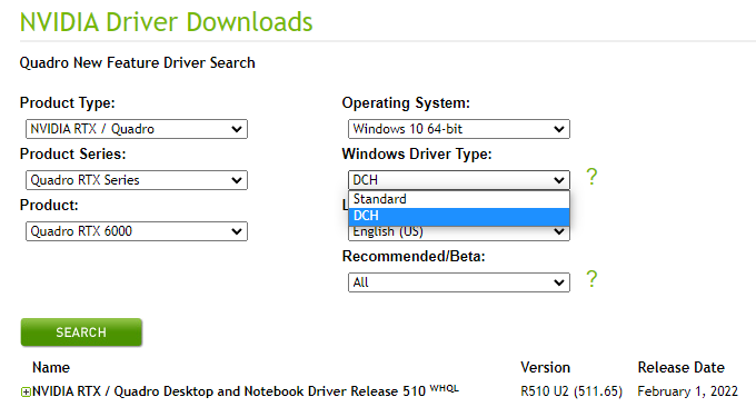

  • The driver type must be set to DCH.
I n the driver page select "Windows Driver Type:" DCH
