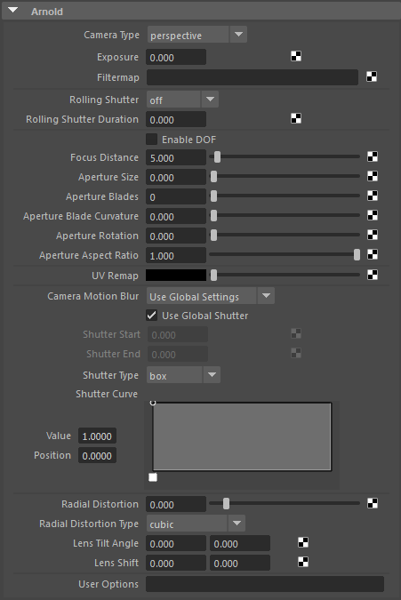

- To change the Arnold camera settings, you need to use the Arnold tab in Maya's Attribute Editor for the camera object (make sure you scroll down past the standard Maya 'Camera Attributes' tab to the tab marked Arnold and expand it).
- Depth of Field is not available for cylindrical and orthographic cameras.
- Camera Motion Blur enables you to turn camera motion blur on or off. 'Use Global Settings' will use the value set in the motion blur tab from the MtoA global render settings. This option can be u seful when there are multiple cameras in a scene that may or may not require motion blur. Use Global Shutter (enabled by default) signifies that the camera should use the values from the Render Settings, in the motion blur tab. When you want to set a specific shutter in the camera, you can disable Use Global Shutter and then it will be taken into account.
