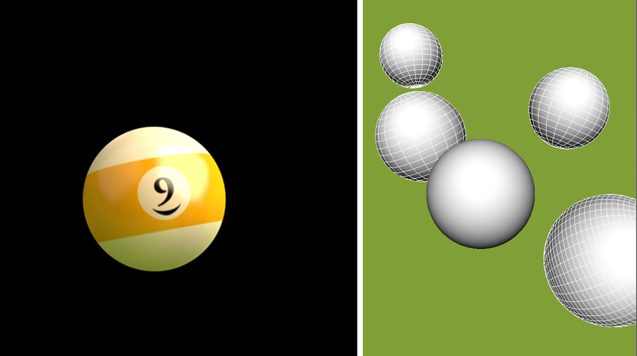

Before we render the Motion Vector AOV, we must first separate the pool ball from the background. We will render the pool ball (with the motion_vector AOV) separately and composite them together in a post-processing program like Nuke.
- Before rendering the pool ball separately, we must enable instantaneous_shutter in the Motion Blur settings. The reason being is that we don't want motion blur in the render, but we still want the motion velocity information in the motion vector AOV.
- Select the geometry in the scene (except the pool ball that we want to motion blur) and disable their primary_visibility. You should just see the pool ball rendered on its own.
| Pool ball render (primary_visibility disabled for the rest of the scene) |

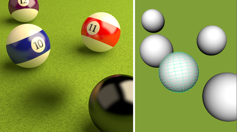

Creating the Background Layer
- Now disable primary_visibility for the pool ball that we want to motion blur. When rendered, you should see the background objects and only the shadow of the motion-blurred pool ball.
| Background render (primary_visibility disabled for the pool ball) |

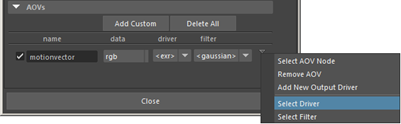

- With the pool ball render layer activated, select the AOV tab in the Render Settings window. Under 'AOV Browser', create a motionvector AOV. Make sure that the AOV filter is set to closest.
- Under AOVs, to the right of the newly created motionvector AOV, there is a downward pointing arrow. Click on that and choose Select Driver from the menu.
| Select Driver by clicking on the downward arrow to the right of the motionvector |

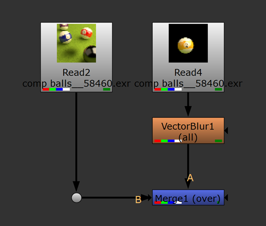

- Open the two EXR files in a post-processing package (in this case Nuke).

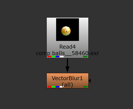

- Connect a 'Vector Blur' node to the pool ball render. We will use the Vector Blur node to blur the pool ball using the 'Motion Vector AOV'.

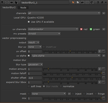

- Select the VectorBlur node. Change the uv channels to motionvector, and the mv presets to Arnold. Enable uv alpha and choose rgba.alpha to prevent the blur from being clipped by the alpha of the motionvector AOV.
| Vector Blur node settings in Nuke |
| VectorBlur alpha disabled: incorrect |
VectorBlur: alpha enabled: correct |
- Use a 'merge' node (operation set to 'over') with its A input as the Vector Blur and it's B input as the background render.
Finally, we should see the pool ball render composited onto the background render as follows:
| Pool ball rendered with Motion Vector AOV |
Background render |
Pool ball composited onto background |
