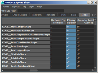

- To render the shadow separately, we will first have to disable Primary Visibility for all of the car objects. Select the car and open Maya's Attribute Spreadsheet window. Select the Primary Visibility column and type 'off' or 0 in the selected column.
Disable Primary Visibility in the Attribute Spreadsheet

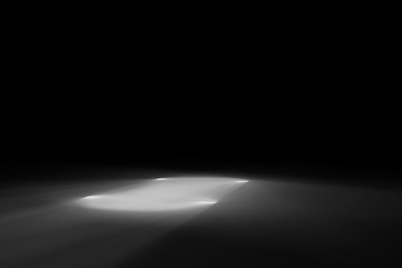

- When you render the car, it will render invisible, but the shadow will remain. The alpha channel should look like the render below:
Ai Shadow Matte render

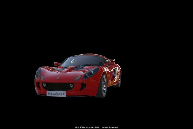

You now have all of the render elements needed to composite a car onto a backplate:
Car beauty render | shadow_matte render | Photographic backplate |
