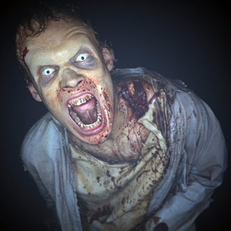

- Create an area light (set to quad). Position and rotate it so that it sits in front of the render camera. Middle drag the Area light onto the camera in the outliner. This will group it to the camera, ensuring that when you move the camera, the light will follow. Increase the exposure of the light to around 4.
| quad_light positioned in front of camera |

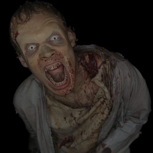

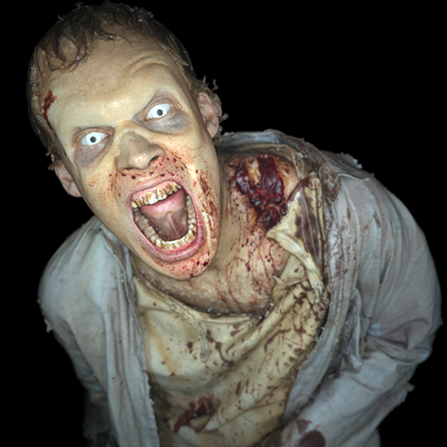

- We can use spread in the quad_light to focus the light more on the zombie's face. In this case, it has been lowered to 0.2.
| spread: 1 (default) | spread: 0.2 |
Low spread values can be noisier than the default high spread, so be careful when using them. The lower the value, the more light samples will be needed to avoid noise in the shadows.
