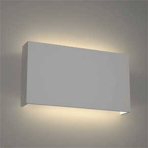

This tutorial shows you how to accurately replicate a real world light from a lighting company using Photometric lights. This particular light consists of twenty-four point light sources (14w LED) in the top and bottom LED boards.

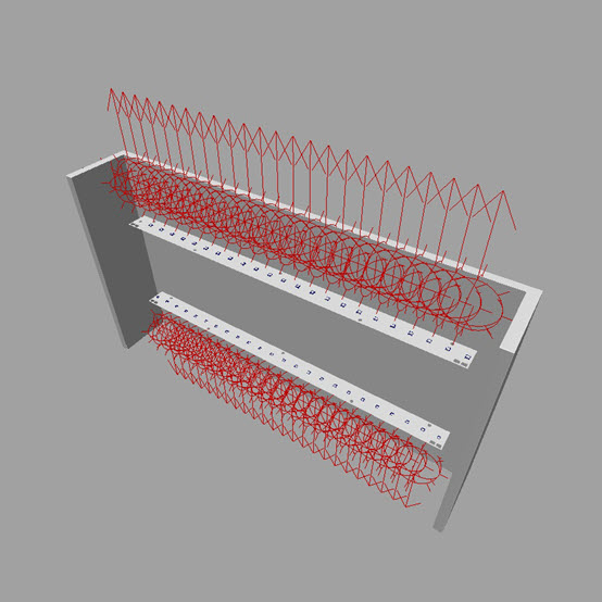

- Start off by creating a Photometric light and position it above the LCD board above the far left LCD hole.
- Duplicate the lights so that there are twenty-four in a row. Duplicate the row and rotate them so that they are pointing downwards as indicated in the image below.
Twenty-four Photometric lights per row |

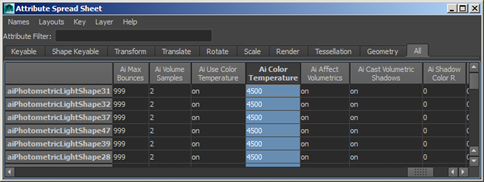

One aspect of lamp color is its color appearance - whether the light from the lamps looks'warm' or'cool' - measured by the correlated color temperature (CCT). Lamps with a warm appearance having a CCT of 2700-3000K are generally considered appropriate in a domestic setting. Lamps of 4000K and above are considered'cool' and are more appropriate for office and some retail applications. The color temperature for this particular light, as indicated by the lighting manufacturer is 4500 K.
- Use the 'Attribute Spread Sheet' window to change MtoA attributes for all of the lights at the same time. Make sure to select the shape node to see the MtoA attributes (use the down key (pickWalkDown) to select the shape node).
