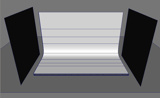

Set Model
The scene consists of a curved backdrop with a floor plane and one plane on either side with a dark gray standard_surface shader assigned to both of them.

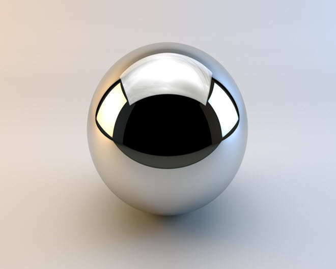

- Test render the scene. You should get something like the image below. If the reflections appear too bright, remember that you can lower the exposure settings in the Arnold attributes for the RenderCam.
The high dynamic range of the HDR maps are visible when the lowering Arnold's camera exposure attribute
The light HDR map details are visible when lowering the camera exposure. You can see the full high dynamic range visible within the specular reflections in the scene:

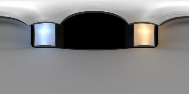

Spherical Camera Lens
Once you have completed this tutorial, why not have a go at converting the scene into an HDR map using the spherical_camera lens.
Scene rendered with Spherical camera lens
