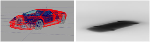

Suppose you want to create an ambient_occlusion render layer that contains only the shadow of a car. Using override sets, you just need to:
  1. Select all of the car geometry that you want hidden.
  2. Create an override set with primary_visibility disabled for the geometry.
  3. Assign an ambient_occlusion shader to the floor.
Car model with primary_visibility override applied to its set (left). Shadow of car is captured via an _ambient occlusion shader on the floor geometry (right).

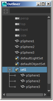

To use override sets, create a set in Maya as a collection of objects, then select the set in the Outliner:

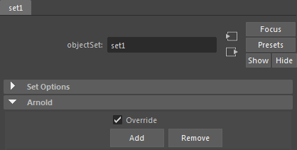

Then, bring up the Attribute Editor, open the Arnold tab, ensure that Ai Override is enabled, and click Add.

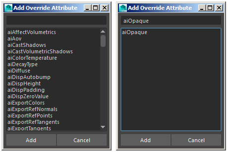

You will then see a window with a (long) list of the attributes that are possible to override.
Note, the Add Override Attribute window may be slow to invoke whenever the set includes many objects. In some cases, it can take a good minute or so for the override attribute window to show up. This is because it has to check hundreds of attributes against the selected objects. Therefore the more objects are selected, the slower it will become.

Search field enables filtering of attributes
There are a lot of attributes that you can choose from! Select those that you require (you can choose multiple attributes if you wish) and click 'Add'.

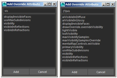

There is a text field at the top which enables you to filter the attribute that you require. It supports all of the features of regular expressions (using the Re Python library).
For example, if you want the filter to ignore caps type (?i) before the query:
By default the text field returns exactly what you type (left). Adding (?i) before the text shows all matches (right).
You can also remove attributes from the override set by clicking on the Remove button on the Attribute Editor.
