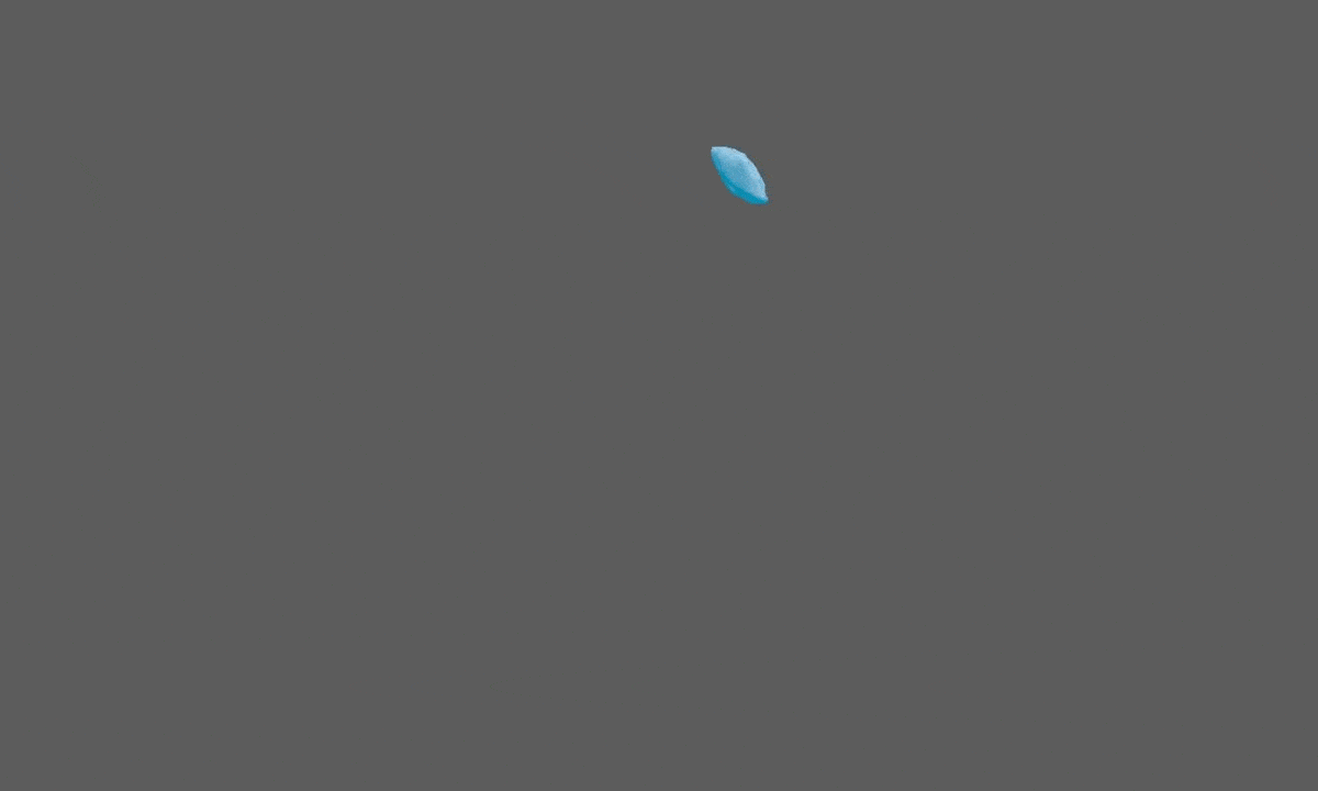

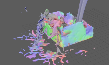

Alembic file opened in Maya
- Scrub through the timeline in order to view the animation. In this case, the animation range is from frame 1 to 100 (the scene is from 40 to 60).

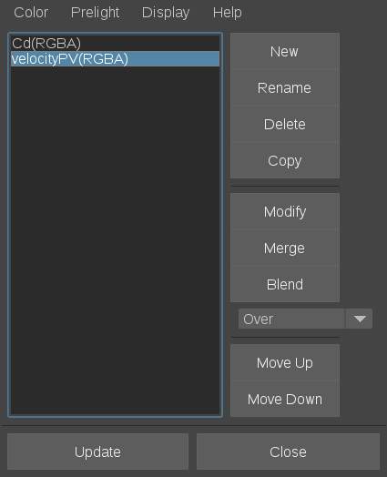

- We can view the color per vertex data that is in the alembic. Select the mesh and go to Color>Color Set Editor and select the velocityPV(RGB) attribute.

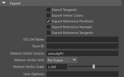

- Select the geometry and make sure the Motion Vector Source field is set to velocityPV
- make sure the Motion Vector Unit is set to Per Second

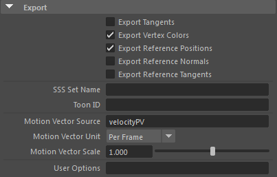

- Finally, make sure Export Vertex Colors is enabled, otherwise, our velocityPV attribute will not be exposed to Arnold

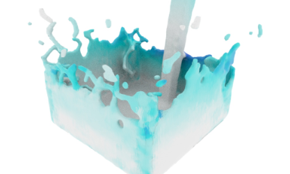

- Open the Arnold Render Settings window. Enable Motion Blur and render the scene. You should now see that the mesh is rendering with motion blur.

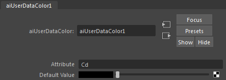

Create an Ai UserDataColor node and connect it to a Standard Surface shader. Assign this shader to the geometry.
Add Cd to Color Attr Name attribute of the aiUserDataColor node.
