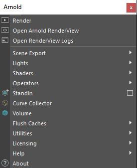

The Arnold RenderView window can be found on the Arnold shelf and under the Maya Arnold menu.

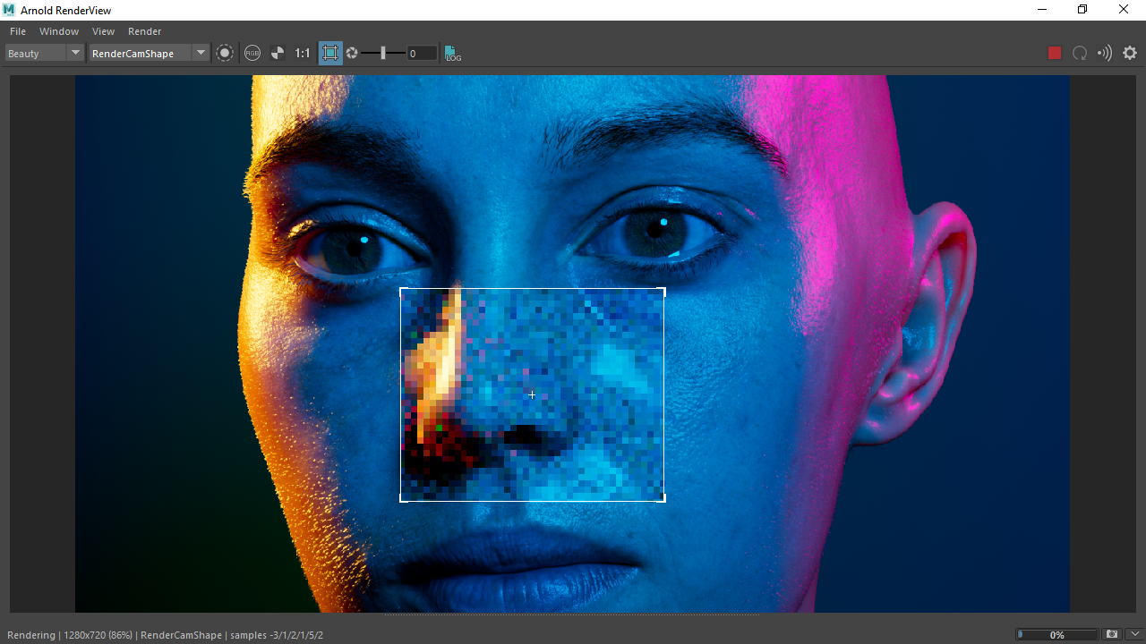

Region Rendering
You can use the Crop Region tool to render it to a specific region only. This can be enabled via the menu Render > Crop Region, by pressing the icon, or by keeping the SHIFT key pressed while dragging a region.
Once the region has been selected, the "crop" option is disabled, so that mouse clicks over the image are seen as "picking" (see the section below).
Note:
To clear the Crop Region and render the whole image, click anywhere on the window while the Crop Region option is active. You can also click on the small cross beside the cropped region to clear the region.

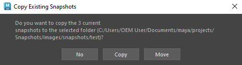

Snapshot library, with thumbnails for each of the stored snapshots. You can also add names and comments.
Snapshots Folder
The snapshot folder where the snapshots are saved to disk. The default snapshots folder inserts a subfolder with the scene name. Changing projects will give the option to copy or move the snapshots (when 'Use Snapshots Folder' is enabled).
Note:
Press the S hot key in the Arnold RenderView to save a snapshot. Press the Left and Right Arrow keys to navigate between snapshots, and the Up and Down Arrow keys to toggle between the display of snapshots and live rendering.

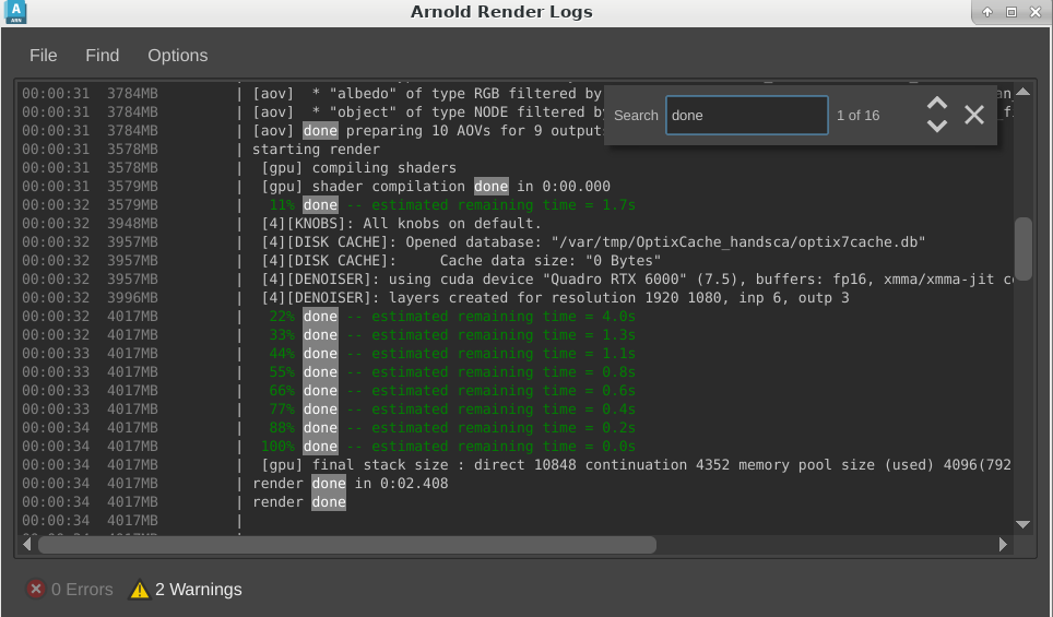

Log
Opens the Arnold Render Logs window where you can view a simple-to-read version of the Arnold log.
IPR Log Frequency
Allows you to control the verbosity of the log during IPR sessions. Last Progressive Step restores the scene verbosity just for the final step by default.
Note:
Information on how to read log files can be found here.

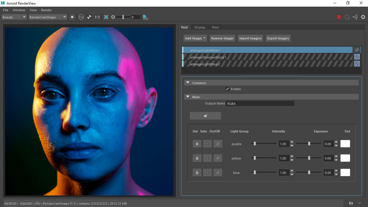

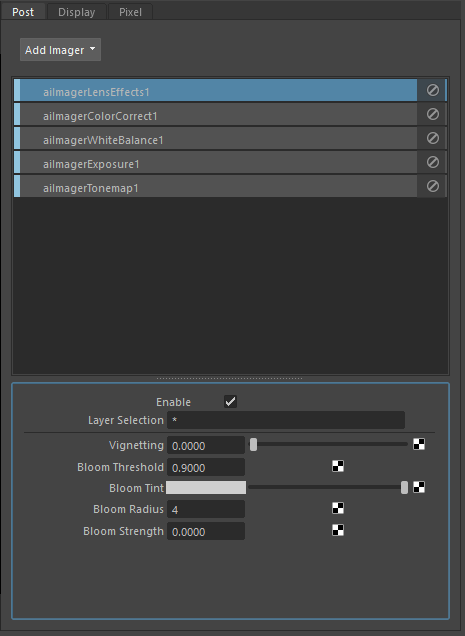

Post
Post-processing nodes called imagers operate on pixels before the output driver. Imagers can be chained together.

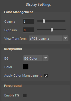

Display Settings
Opens the color correction panel on the right side of the RenderView window, offering various options for adjusting the displayed pixel colors.
  • Gamma: adjusts the displayed colors with a simple gamma curve.
  • Exposure: expose the displayed image up or down, in f-stops.
  • View Transform: choose the default color transform to apply for viewing images in the RenderView.
The overexposed areas near the windows of the interior scenes below particularly benefit from tone mapping.
The RenderView updates the View Transform according to Maya's Color Management settings (including Syncolor native view transforms which are used by default). It is however still possible to override the view transform in ARV only, as with other Maya viewers.
Note:
It is recommended that you use the ACES Color Management.
Background
It is sometimes useful to change the color of background pixels in the displayed render.
  • BG Color: applies a flat background color.
  • BG Image: displays a background image or texture.
  • BG Checker: displays a checkerboard pattern as the background.
  • Color: applies a flat background color.
  • Apply Color Management: applies Color Management settings to the Background.

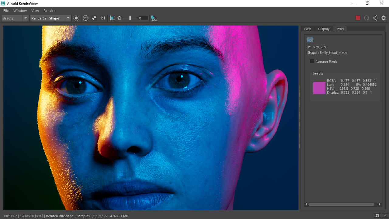

Pixel Information
Shows detailed values for the pixel below the mouse cursor, on all AOVs.
  • Pixel XY: coordinates corresponding to the mouse position within the rendered image.
  • Shape: The name of the shape below the mouse cursor.
  • Average Pixels: T he pixel value that becomes averaged around the surrounding pixels.
  • RGBA values as returned by Arnold, below the mouse cursor.
  • Luminance values as returned by Arnold, below the mouse cursor.
  • HSV values as returned by Arnold, below the mouse cursor.
  • Display: Color corrected values below the mouse cursor.
Pixel Information values

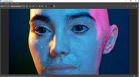

  • Occlusion: use ambient occlusion shading.
  • Wireframe: displays geometry as a wireframe.
  • Normal: visualizes the normal vector (between 0 and 1, in tangent space).
  • UV: displays the coordinates of the primary UV set (red=U, green=V).
  • Primitive ID: displays random colors based on the per-primitive (triangle, curve) index.
  • Barycentric: displays intra-primitive parametric coordinates (barycentric for triangles, parametric length, and width for curve segments).
  • Object: displays random colors based on the per-object ID.
  • Isolate Selected: Isolates the selected node in the render. The following nodes can be selected:
  • Geometry: renders the selected geometry only; all other geometry is rendered as a black matte.
  • Materials: renders the selected material only; all other materials are rendered as a black matte.
  • Shaders: any individual shader (utility, texture, blend, etc.) part of a shader tree can be isolated, showing its resulting output in the render. Any geometry whose shading tree does not contain the isolated shader is rendered as a black matte.
  • Light: isolating a light means that all other lights are disabled, and the scene is lit exclusively with the selected light.
