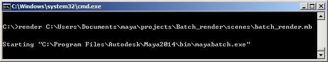

Command-Line Rendering
Before saving the Maya file for batch rendering, make sure that the project is set correctly, that the renderer is set to Arnold and that the camera (and other settings) are set correctly in the Render Settings window.
To render using the renderer specified in the scene file, type render, followed by any batch render flags, and then the Maya scene pathname:
Render -s 1 -e 10 C:\Users\Documents\maya\projects\Batch_render\scenes\batch_render.mb
Maya scene batch rendered in a Windows Shell
Remember, you can list the render flags using 'Render --help -r arnold'

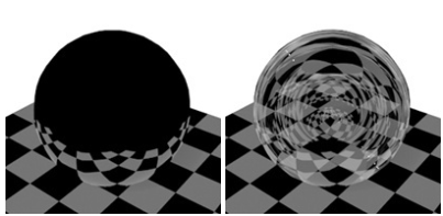

Render Flag: ai:rfr
If you need to change the refraction ray depth in your scene, you can use the following commands:
Render -r arnold ai : rfr 0 C:\Users\Documents\maya\projects\Batch_render\scenes\batch_render.mb |
Where ' ai:r fr 0' se ts the refraction depth to 0.
ai:rfr 0 (left). ai:rfr 4 (right).
