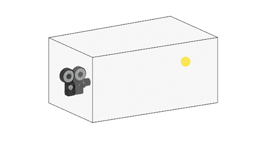

Start off by creating a cube and scaling it out in one direction.
Select the end face of the cube and taper it out slightly. This will help to create more internal reflections.
Create a point light and position it towards the back face (tapered end) of the tapered cube.
Create a camera and position it at the other end of the cube (inside it) pointing at the point light.
Camera pointing at a point light inside a tapered reflective cube

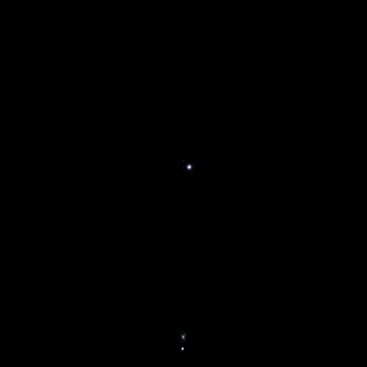

Render using the default specular_ray_depth: 1

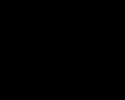

Specular Ray Depth
- Try increasing the specular_ray_depth to see more internal reflections of the point light.
Increasing the specular_ray_depth value will dramatically increase render times.
| 1 (default) | 10 | 20 |
You may need to increase the number of specular samples to resolve some of the specular_roughness noise for final rendering.
