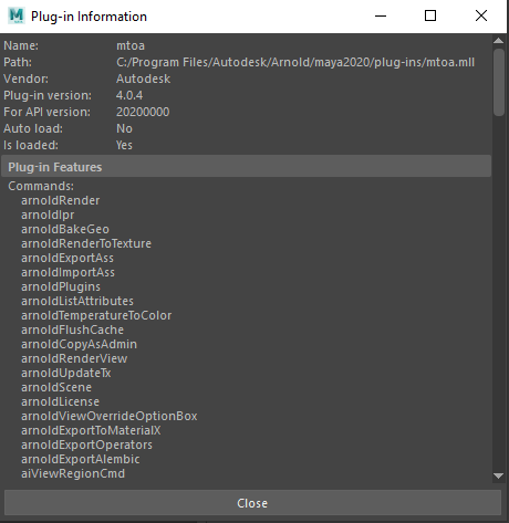

Below is a list of mel commands (and corresponding flags) that work with MtoA. These mel commands can save time when used as hotkeys in Maya to speed up your workflow for example.
