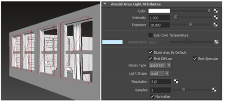

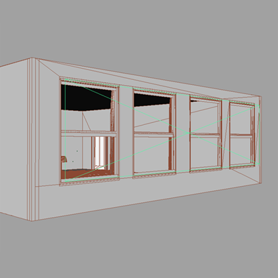

Four Ai Area Lights pointing through the windows
A common method for lighting an interior is to place area lights outside of the windows pointing into the room. Care must be taken with the size and position of the lights. If the lights are too close to the window frame it can cause areas near the windows to appear bleached out (see tone mapping below). A light sample value of 3 has been used in all of the example images.
Remember that you can also combine a directional_light with the window quad area_lights to achieve a similar effect as the skydome_light.
- Create four area lights and position them outside of the windows as indicated in the below-left image. The settings used for the four area lights in the scene are below. The exposure has been increased to 18, the Light Shape has been set to quad and the samples have been increased to 3 for final scene rendering.
Ai Area light shape set to quad
With windows that contain glass, the area_lights should be placed in front of the glass so that Arnold does not need to deal with glass intersections. However, if the window is oddly shaped, then placing it right behind the window, so that the entire window is covered by the quad_light would be the next easier option.

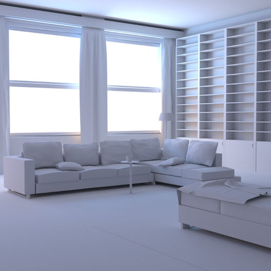

Light Decay filter
Near Attenuation
The areas around the windows are very bright and bleached out. One way to fix this is using tone mapping (see below). The other is to use a Light Decay filter.
- Connect one light_decay filter to all four area lights.** With this filter, it is possible to control the falloff of the light using the Use Near Attenuation attributes. In the below right image the Near Start is set to 40 and Near End is set to 200. You can see that the area on the floor near the lights is far less blown out when compared to the render that has no Light Decay filter (diffuse_samples has been set to 0 in order to better see the effect).
| No light_decay filter (area around window appears bleached out) | The Light falloff is improved using a light_decay filter |

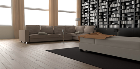

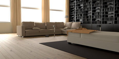

Tone Mapping
An easy way to fix the bleached-out areas around the window is to 'tone map' the image using post-processing software.
- Render the scene as a 32-bit EXR file. This will give you enough tonal range to play within post.
| Before tone mapping (area around window is bleached out) | After tone mapping |

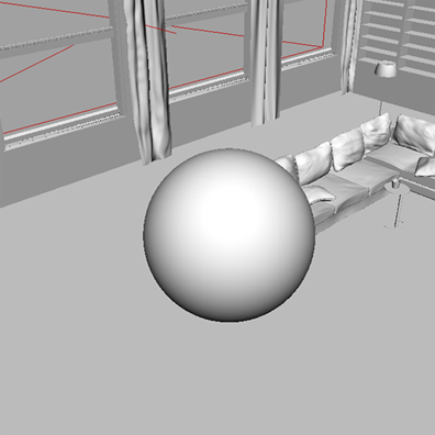

Decreasing the intensity of the light until it is within a normal range should be sufficient to see the effect of the HDRI. However, it can be difficult to tell if the texture map has been mapped correctly to the light. In order to better visualize the effect, we can create a reflective sphere and place it in front of the window. This way we can see the HDRI reflected in the sphere.
| A single area_light scaled to fit all of the windows | HDRI -> area_light |
- Create a sphere and assign a standard_surface shader to it. Reduce the base_weight to 0, increase the specular_weight to 1 and decrease the specular_roughness to 0. Render the sphere in the scene. You should see the HDR reflected in the sphere as in the image below right.
| Reflection of HDRI mapped to area light is visible in the sphere | Reflective sphere placed in front of window |

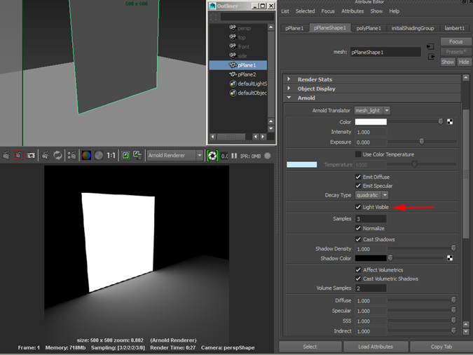

It is not possible to make Arnold's lights visible to the camera. However, the mesh_light does have a Light Visible option.
mesh_light (poly plane) with Light Visible enabled
