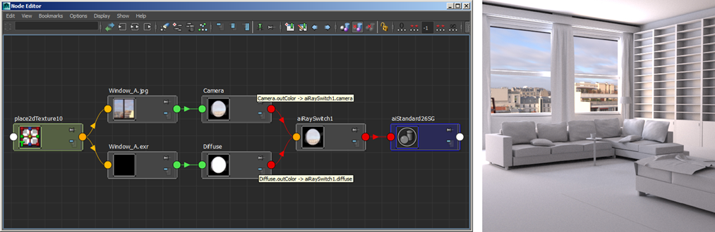

The window HDRI appears blown out when assigned to the emissive plane. A way around this is to use the Rayswitch shader. A Standard Surface shader with the HDRI image is used to control Diffuse GI rays and another Standard Surface that contains the same image as a JPEG is used for the camera rays.
Rayswitch shader assigned to emissive plane geometry. The window JPEG texture is visible to camera rays, while the HDRI is visible in diffuse rays
The window HDRI appears blown out when assigned to the emissive plane. A way around this is to use the Ai Rayswitch shader. An Ai Standard Surface shader with the HDRI image is used to control Diffuse GI rays and another Ai Standard Surface that contains the same image as a JPEG is used for the camera rays.
Rayswitch shader assigned to emissive plane geometry. The window JPEG texture is visible to camera rays, whilst the HDRI is visible in diffuse rays
