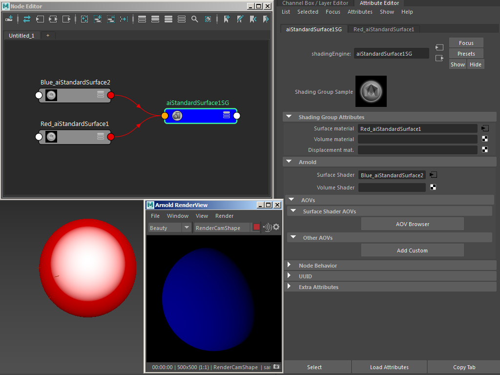

Surface shader
There is a surface_shader slot in the Arnold section of Shading Engines. When a shader is connected to this slot, it will be used instead of the Maya surface shader. When nothing is connected, the Maya surface shader will be used; so it will not break backward compatibility. This can be useful in situations where you might need to display a shader in Maya's viewport that is different from the one that is assigned to the same surface. You could, therefore, connect both a Maya shader and an Arnold shader to the same shading engine because each renderer has its surface shader slot.
In the example below, a blue standard_surface shader is connected to the Arnold Surface Shader attribute of a red standard_surface shading group. The sphere is shaded with a red standard_surface shader in the viewport but renders as the blue standard_surface.
blue standard_surface -> Surface Shader

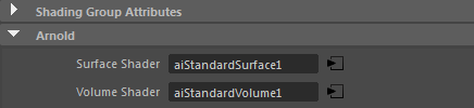

Volume Shader
There is a Volume Shader slot in the Arnold section of Shading Engines. When a shader is connected to this slot, it will be used instead of the Maya surface shader. When nothing is connected, the Maya surface shader will be used; so it will not break backward compatibility.

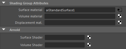

Volume Attributes for a polymesh
- Connect a standard_volume shader to volume_shader in the Arnold attributes of the Shading Group for the shader assigned to the sphere.
Standard_volume connected to Volume Shader in the Shading Group Attributes of a Standard Surface shader

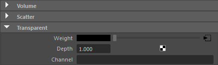

- Create a 3d noise texture and connect it to the transparent_weight attribute of the standard_volume (in this case a Maya 'Cloud' texture has been used).
Maya Cloud -> Transparency of standard_volume

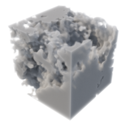

You should end up with something that looks like this:
