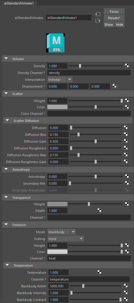

Standard Volume
The standard_volume is a physically-based volume shader. It provides independent control over volume density, scatter color, and transparent color.

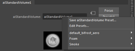

Note:
Legacy Bifrost presets are available in the Attribute Editor for standard_volume.
