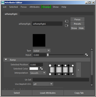

Ramp RGB
- Connect a ramp_rgb to the specular_anisotropy parameter.
- Change the ramp_rgb type to radial. Insert four black and four white colors into the ramp. Change their interpolation to smooth.

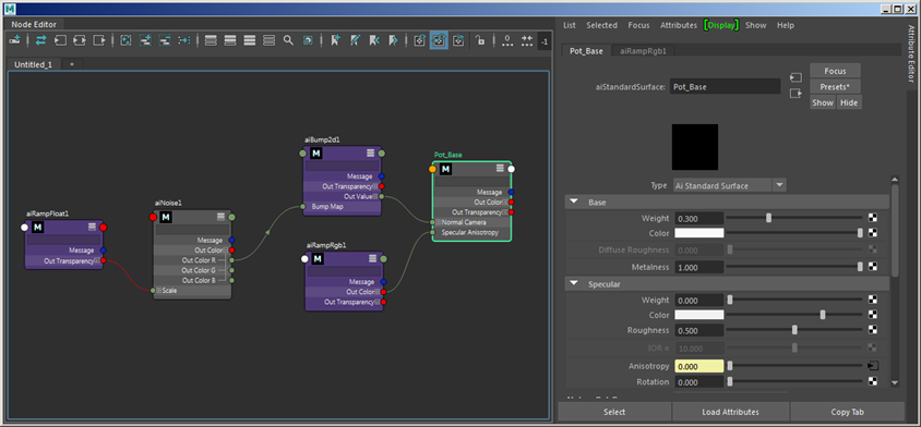

RampRGB -> specular_anisotropy of standard_surface
Bump Map
Now we need to create a scratch effect and connect it to the bump attribute to achieve a subtle brushed metal effect. We can do this using the following shaders:
RampFloat -> Noise -> bump2d
- Create a bump2d and connect it to the normal_camera of the pots base shader. Set the bump_height to around 0.5.
- Create a noise shader and connect it to the bump_map of the bump2d. Change octaves to 8 and amplitude to around 0.4.
- Create a rampFloat and connect it to the scale of the noise shader. Change the type to circular. This will give us the concentric ring effect that we want.

Final shading network
