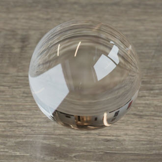

Glass Sphere
- Create a polygon sphere and position it so that it sits on the center of the plane.
- Assign a standard_surface shader to it. Change the following parameters to match that of glass:
base_weight: 0
specular_roughness: 0
specular_ior: 1.52
transmission_weight: 1
A glass preset is available in the presets menu in the attribute editor for the standard_surface shader.

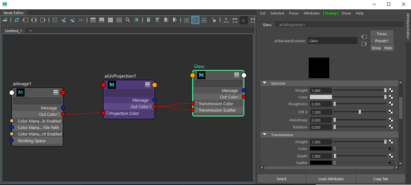

Transmission
Now we need to connect our marble texture to the transmission_color and transmission_scatter. Transmission_scatter is suitable for any material that is fairly thick or where there is enough of it for scattering to be visible, such as honey. Transmission_scatter with depth is key to the look for our marble shading.
- Create an image shader and open the marble texture that you want to use.
- Connect the image to a uv_projection shader. We want to map the texture spherically around the sphere so change the projection_type to spherical.
- Connect the uv_projection to the transmission_color and transmission_scatter of the glass standard_surface shader.
- Increase the transmission_depth to 1. You may want to experiment with this value depending on the texture that you are using and the look that you want to go for. Changing this value will have a large effect on the overall marble shading, as you can see in the images below.

Final shading network for the glass marble

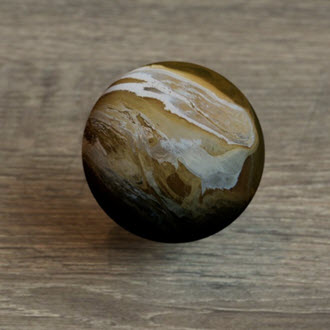

Now, this is looking pretty good as it is. However, let's try to improve it further by adding an interior to the marble using a volume inside the glass sphere.
Volume
Start off by duplicating the glass sphere and scaling it in slightly to around 0.9 in X, Y, and Z.
Select the sphere and go to the Arnold volume attributes in the Attribute Editor.
- Change the step_size to around 0.1. Now the sphere will render as a volume.
Smaller (and therefore more accurate) step sizes will increase render times while larger sizes will render more quickly.
- Assign a standard_volume shader to the inner sphere and hide the glass sphere for now so that we can focus on the volume shading. In this example, we have used the default volume_density of 1. However, depending on the texture that you are using and the look that you are trying to achieve it could be worth experimenting with this value.

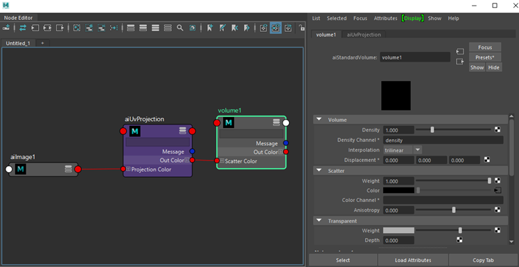

Volume Scatter Color
Now we want to add color to the volume using the same image (and projection) that we used for the glass shader.
- Connect the original uv_projection to the scatter_color of the standard_volume shader.
image -> uv_projection -> volume.scatter_color
- If the volume appears overly bright, try increasing the transparent_weight and transparent_depth of the standard_volume shader. Adjusting these attributes can really help sell the effect of merging the glass with the volume underneath.
Final shading network for the volume

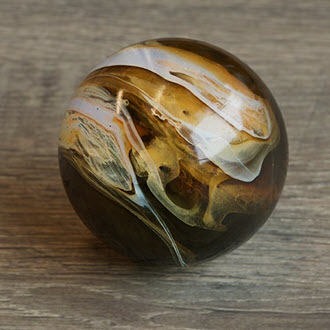

Final Rendering
- Now unhide the glass sphere and render the scene.
Make sure that the skydome_light has enough volume_samples otherwise the volume will appear noisy.
Marble glass shading with volume inside
- Finally, try adding a scratch texture to the specular_roughness of the glass shader (via a range shader for extra control). This will help to break up the specular reflection and will add more realism to the final render.
