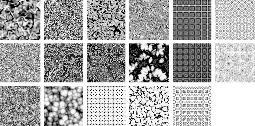

Noise Shaders

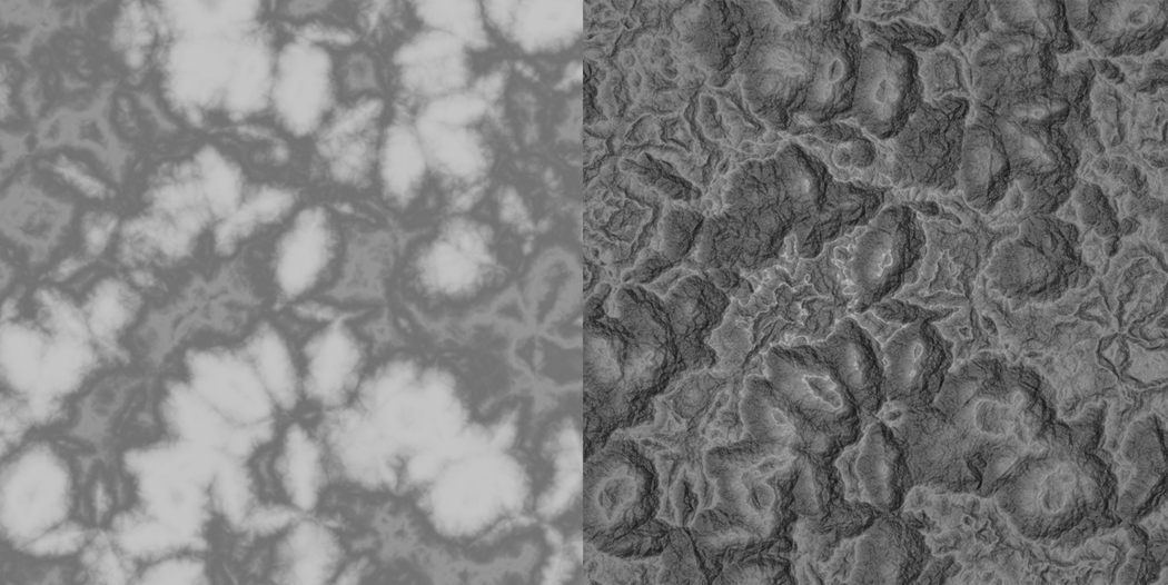

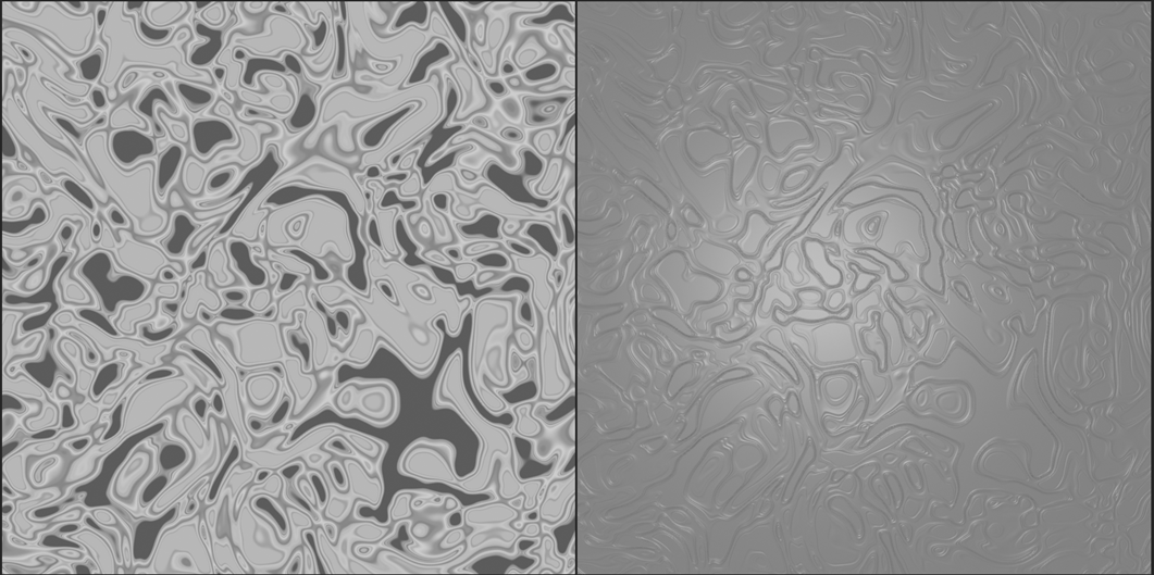

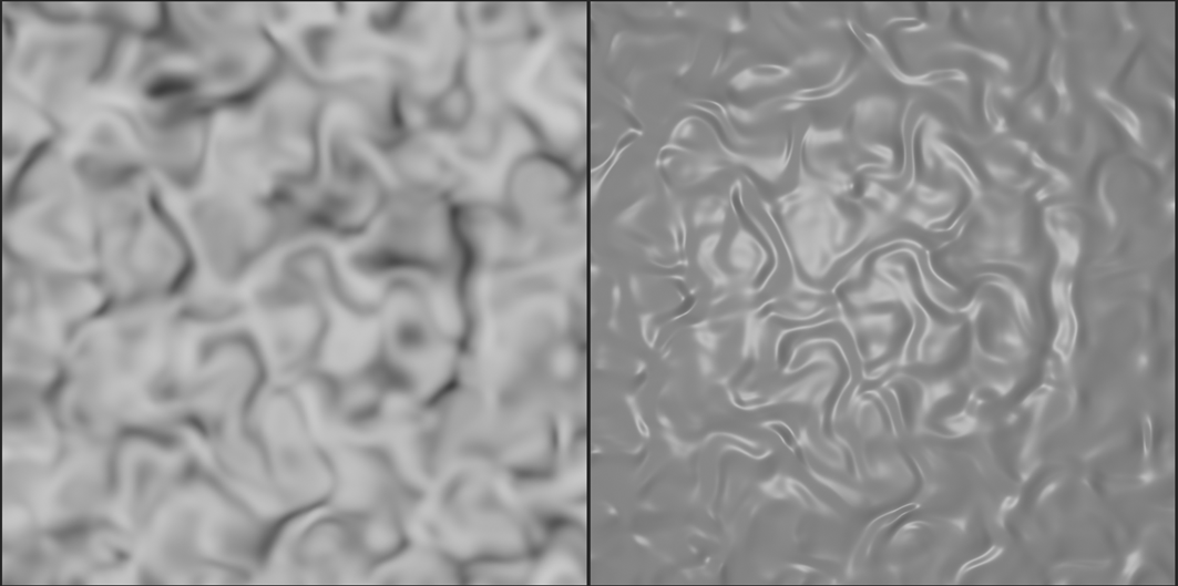

Noise Type 1
Octaves: 1. Distortion: 1.2. Lacunarity: 1. Scale XYZ: 10

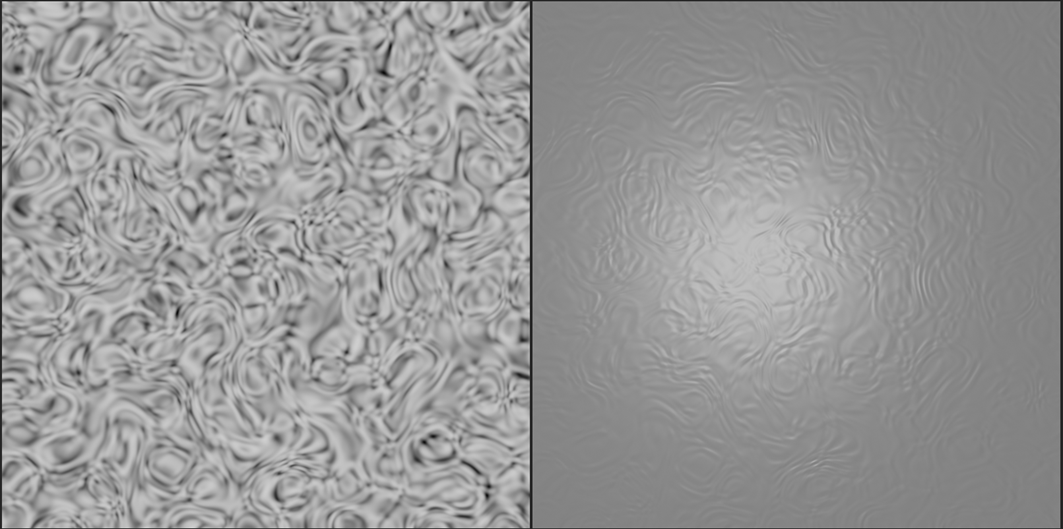

Noise Type 2
Octaves: 1. Distortion: 5.2. Lacunarity: 1. Scale XYZ: 10.

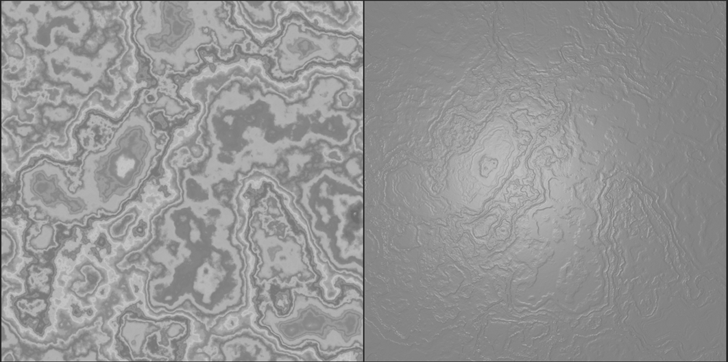

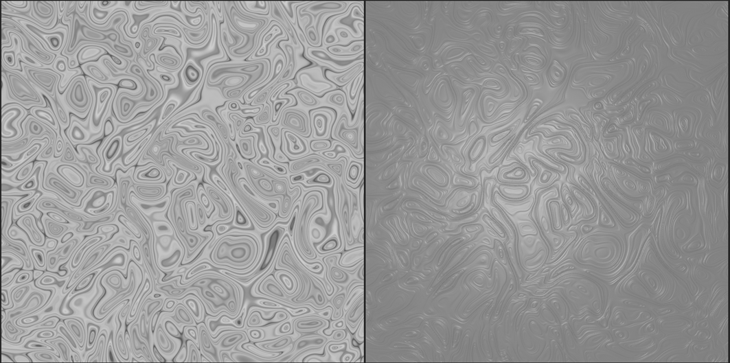

Noise Type 3 (Noise x2)
Create a Noise shader and set the following parameters:
- Octaves to 1.
- Distortion to 5.
- Lacunarity to 3.25.
- Scale XYZ to 0.
Next, create another Noise shader rzits output to the Offset parameter of the first Noise shader. Set the following:
- Octaves to 5
- Distortion to 4
- Lacunarity to 1
- Scale XYZ to 5

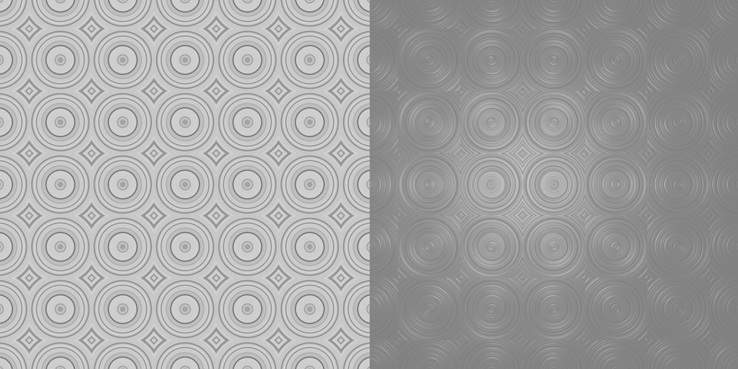

Noise Type 4 (Noise x2)
- Octaves to 1
- Distortion to 5
- Scale XYZ 10
Next, create another Noise shader and connect its output to P parameter of the first Noise shader. Set the following:
- Octaves to 2
- Distortion to 3
- Lacunarity to 1
- Amplitude 0.21
- Scale XYZ to 5

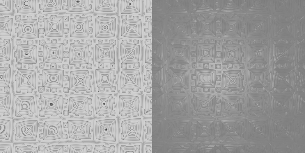

Noise Type 5 (Noise x2)
- Octaves to 1
- Distortion to 6.7
- Lacunarity to 1
- Scale XYZ 5
- Octaves to 4
- Distortion to 0
- Lacunarity to 2.68
- Amplitude 0.719
- Scale XYZ to 10

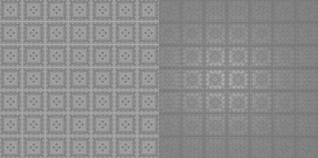

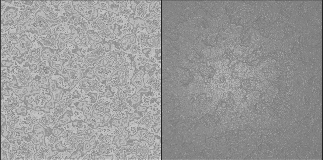

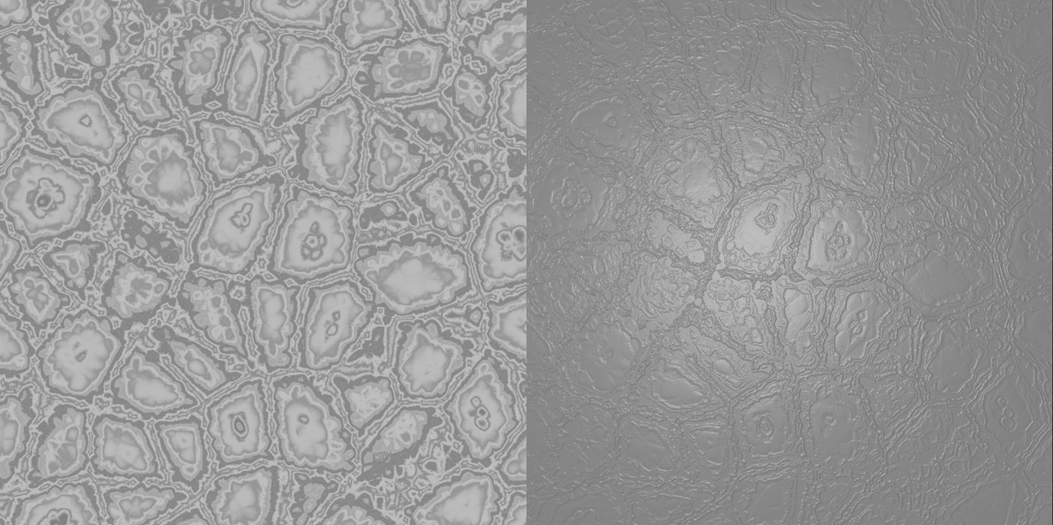

Noise Type 6 (Cell Noise ->Noise)
- Octaves to 1
- Distortion to 3.1
- Lacunarity to 1
- Scale XYZ 6
Next, create a cell_noise shader and connect its output to P parameter of the first Noise shader. Set the following:
- Octaves to 7
- Lacunarity to 2.806
- Scale XYZ to 7

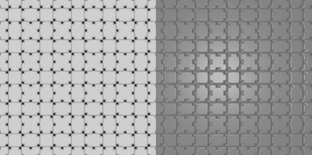

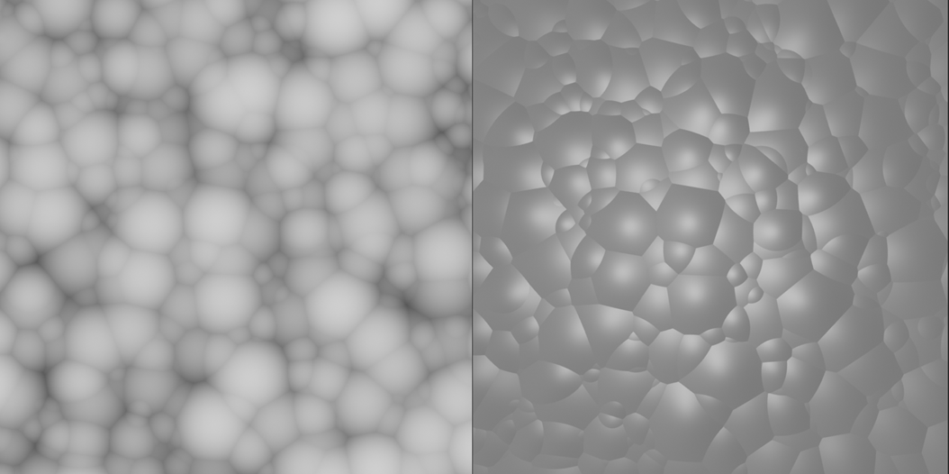

Cell Noise Type 1
Create a cell_noise shader and set the following parameters:
- Disable Additive
- Set Octaves to 4
- Lacunarity to 1.274
- Scale XYZ 10

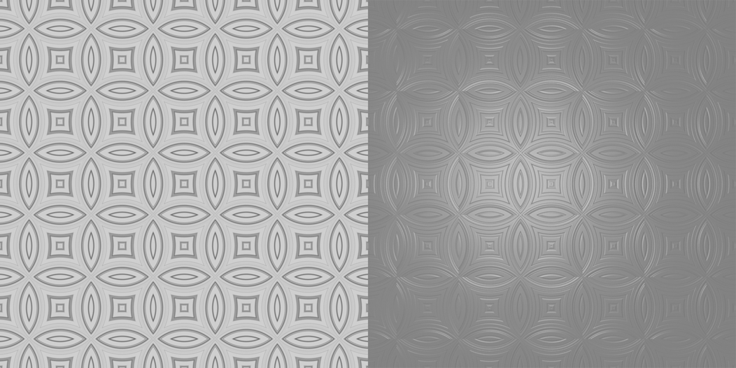

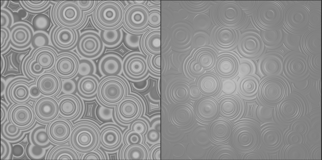

Cell Noise Type 2 (Cell Noise -> Range)
- Change Pattern to alligator
- Disable Additive
- Octaves to 2
- Lacunarity to 1.5
- Amplitude to 1
- Scale XYZ to 10
- Density to 0.326
- Randomness to 0
Next, create a range shader and connect the cell_noise to its input parameter. Set the following:
- Input Max to 0.343
- Enable Smoothstep

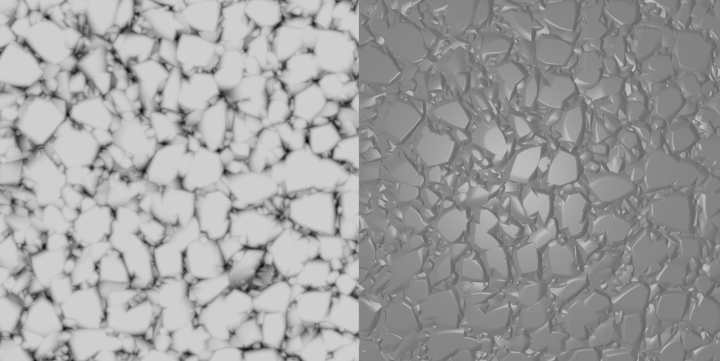

Cell Noise Type 3 (Cell Noise -> Range)
- Disable Additive
- Octaves to 6
- Lacunarity to 1.297
- Amplitude to 1
- Scale XYZ to 10
- Density to 0.326
- Randomness to 1
Next, create a Range shader and connect the Cell Noise to its input parameter. Set the following:
- Enable Smoothstep

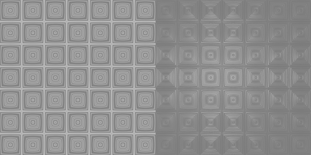

Cell Noise Type 4 (Cell Noise -> Cell Noise -> Range)
- Enable Additive
- Set Octaves to 3
- Amplitude to 1
- Scale XYZ to 10
- Density to 0.326
- Randomness to 1
Create another cell_noise and connect its output to P parameters of the first Cell Noise. Set the following:
- Change Pattern to worley2
- Enable Additive
- Octaves to 3
- Lacunarity to 1
- Amplitude to 1
- Scale XYZ to 6
- Density to 0.5
- Randomness to 0
- Enable Smoothstep
