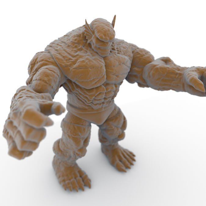

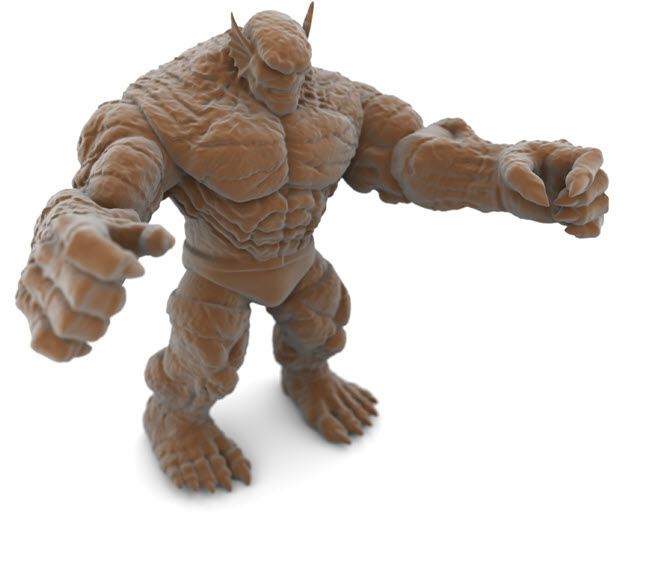

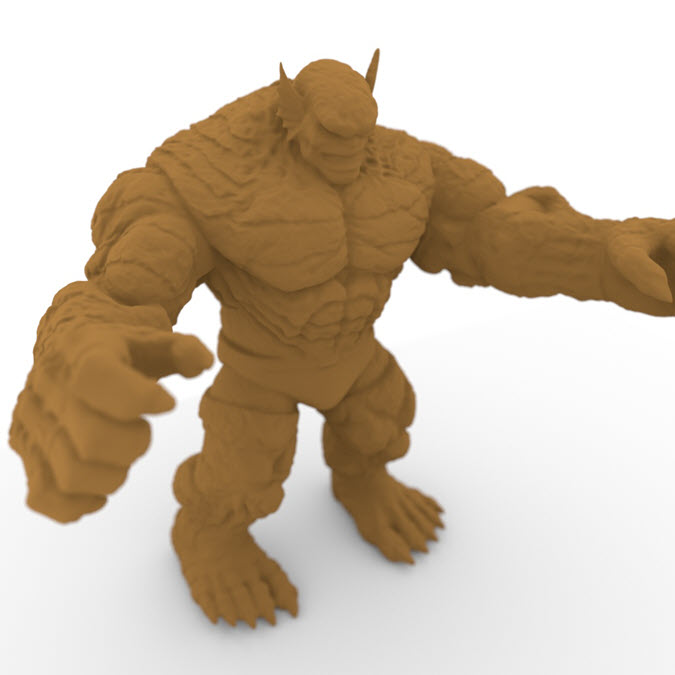

| No rim shader (standard_surface) | Rim shader color set to white |

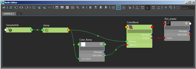

- A SamplerInfo node is connected to a ramp which determines the color of the rim light effect. This is connected to the base_color attribute of a standard_surface shader.
Rim shader network
- Changing the color of the ramp will affect the rim lighting effect. You can adjust the width and strength of the rim effect using a ramp texture.
| Ramp color set to yellow | Ramp color set to black |
