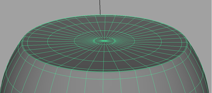

Liquid Meniscus
The top of the liquid has been modeled accurately with a meniscus. A meniscus is a curve in the upper surface of a liquid close to the surface of the container or another object, caused by surface tension.
Model the liquid meniscus. Ensure you have enough edge loops to pull the top of the surface down.
