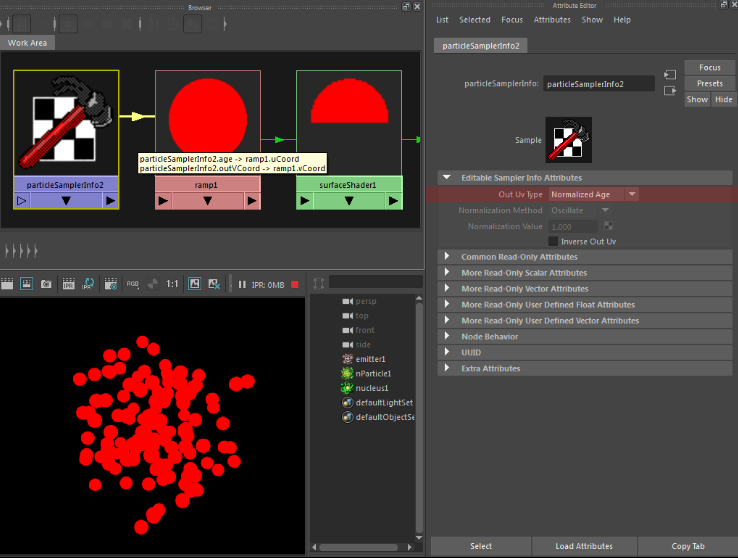

Particle Sampler Info
MtoA does not export the particleSamplerInfo node. It exports some "userDataXXX" nodes and they require that the info is exported within the particles object.
The example below has a particleSamplerInfo connected to the Uv Co-ordinates of a ramp texture and the Out Uv Type is set to Normalized Age:
The particleSamplerInfo is ignored and the particles remain the same color over time

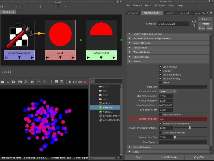

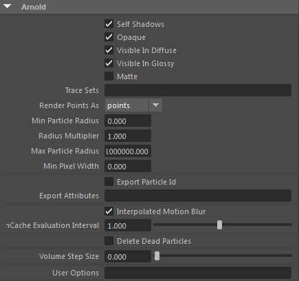

By default, this will not work. However, it can be achieved by selecting the particleShape node, and in the Arnold section, in the Export Attributes, type 'age':
Adding 'Age' to the Arnold Export Attributes for the ParticleShape node fixes the connection to the ParticleSamplerInfo node
A Maya scene file that demonstrates the above particle sampler info workflow can be found here.
