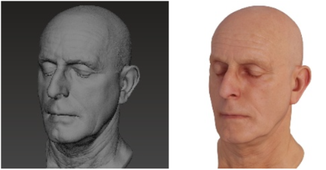

- Open the head scene file. You will need to assign a standard_surface shader to it and connect the relevant texture maps to it.

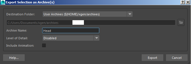

Select the head mesh and go to Generate>Export Selection as Archive(s)... (alternatively you can convert a saved scene to an archive using Create from Selection... under Archive Files once the description has been created).
The Export Selection as Archive(s) window should appear. Change the Archive Name to Head.
Select a folder where you want XGen to save the archive file and select Export. XGen will then export the model as an archive file within the selected folder.

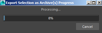

You should see the Export Selection as Archive(0) Progress window when XGen is exporting the mesh:

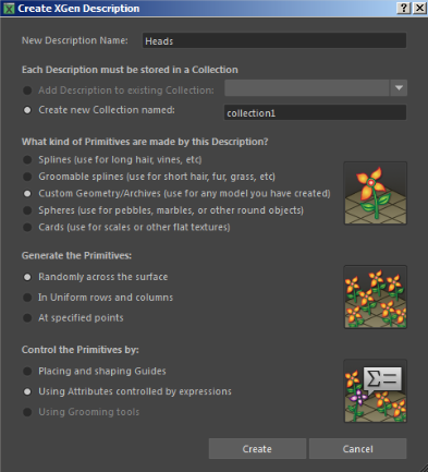

The Create XGen Despcription window will appear. Change the New Description Name to Heads.
Choose Custom Geometry/Archives (use for any model you have created) as indicated in the image below:

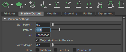

- The XGen window should replace the attribute editor. Before opening the archive file, reduce the Percent value to a low value in the Preview Settings (Preview/Output tab). This is a good habit to get into as XGen could automatically create many instances in the viewport, depending on settings such as the Density. If the percentage is too high it can cause Maya to crash without any prior warning.
Lower the Preview/Output Percent

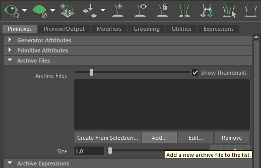

- Go back to the Primitives tab. Scroll down to Archive Files and select Add.
Go to the location where you saved the XGen archive file and select it. It should be called something like Head-model.xarc

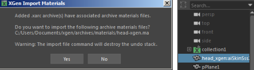

You will be prompted with the following window. Select Yes to import the materials that were saved with the archive file (you can change the material assignment later if you wish to do so).
Import head material into scene

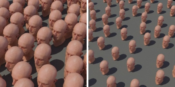

Density
Increasing the Density will increase the number of primitives.
Left: 50. Right: 90.

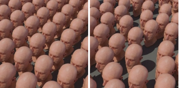

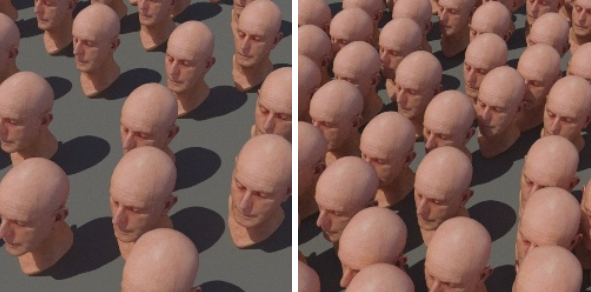

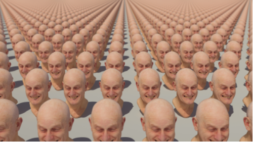

- XGen has placed the heads randomly across the surface because this is the default option when creating a description. If you want the primitives to be placed in rows and columns, you can do so by selecting In uniform rows and columns in the Generate Primitives menu under Generator Attributes (Primitives tab).
Heads placed in uniform rows and columns (left). Heads placed randomly across the surface (right).

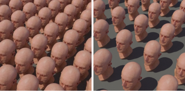

Spacing
- When Generate Primitives is set to In uniform rows and columns the Spacing attribute replaces Density. Increasing the Spacing attribute increases the distance between the primitives.
0.1 (left). 0.15 (right).
