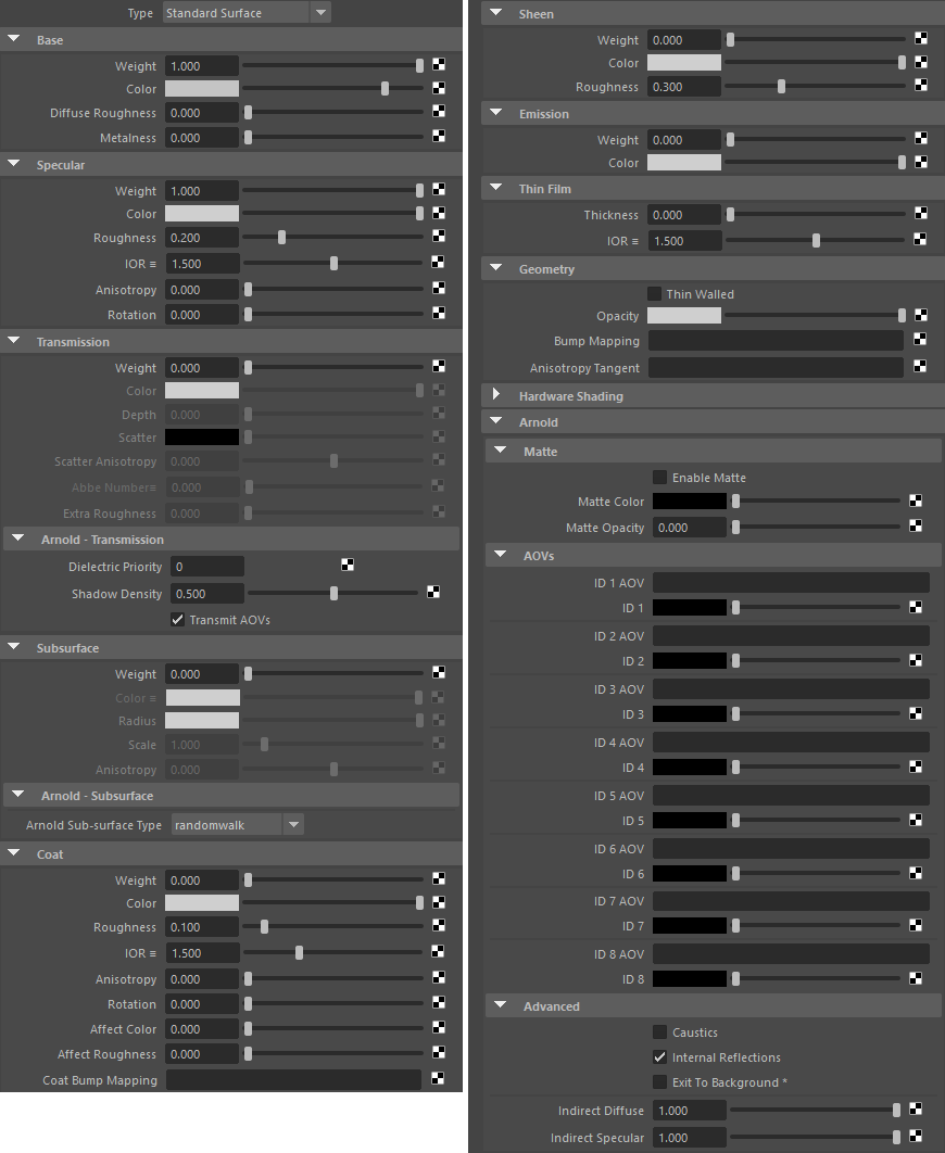

The standard_surface shader is a physically-based shader capable of producing many types of materials.

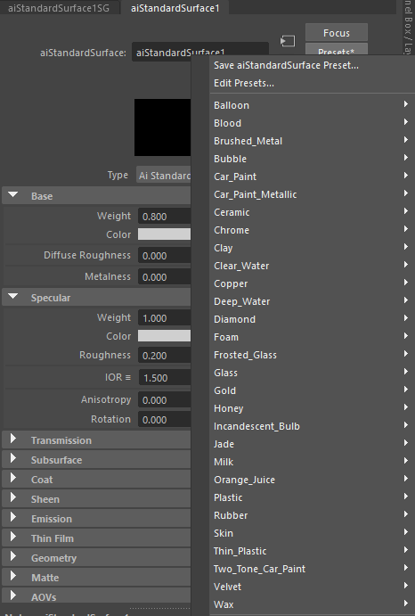

Standard Surface Presets
standard_surface presets available in the attribute editor

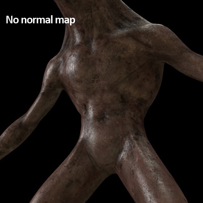

Normal mapping works by replacing the interpolated surface normal by the one evaluated from an RGB texture, where each channel (Red, Green, Blue) represents an axis and strength for the bump. It can be faster than bump mapping since bump mapping requires evaluating the shader underneath three or more times.
When using Color Management in Maya (2017), normal maps should be set to RAW.

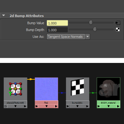

In the example below a normal map is connected to a Maya bump2d node which is connected to the bump mapping attribute of a Standard Surface shader.
Note that adjusting the Bump Depth attribute will have no effect on the normal map.
Normal map -> Maya bump_2d. 2d Bump set to tangent_space_normals
