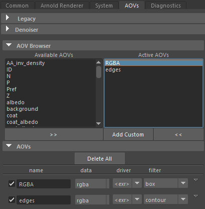

RGBA (box_filter) and edges custom AOV (contour_filter)

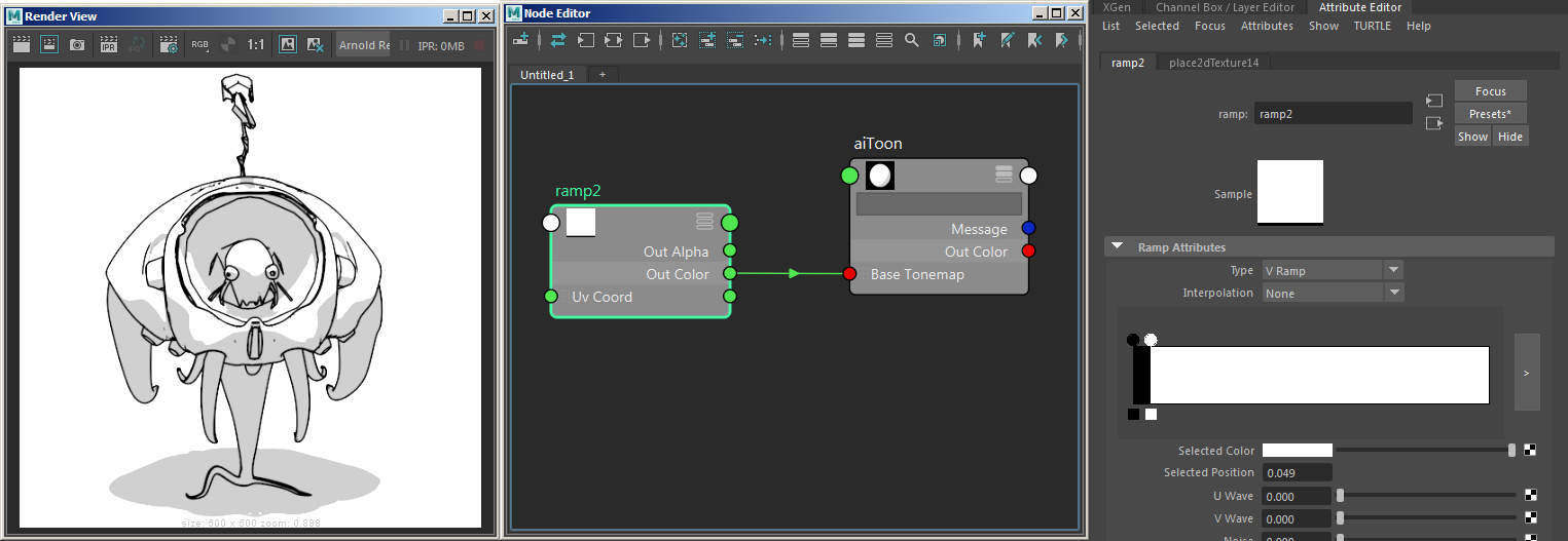

Example use of base_tonemap

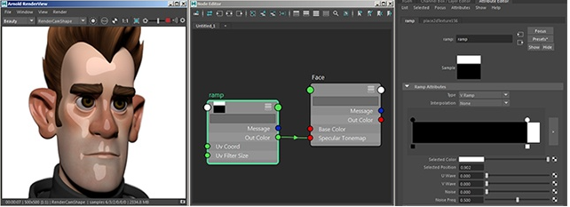

Ramp -> specular_tonemap

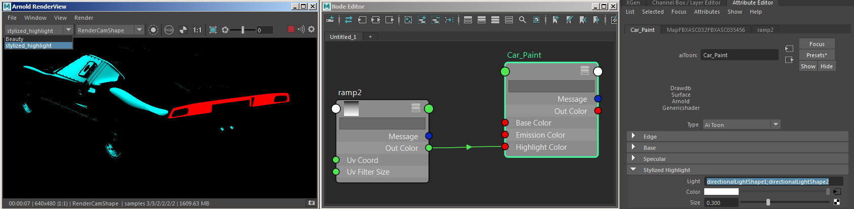

Multiple (blue and red) lights used for Stylized Highlight - 'directionalLightShape1;directionalLightShape2'.

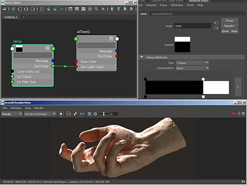

Directional light used for rim_lighting
