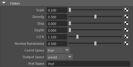

This shader creates a procedural flake normal map that can be used for materials such as car paint.

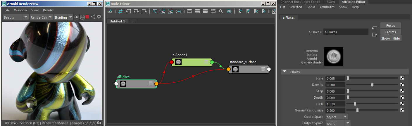

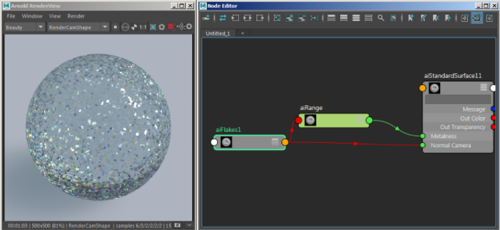

A typical workflow would be to connect flakes to the standard_surface.normal_camera.
flakes -> normal_camera and metalness of _standard_surface _(via a range shader)

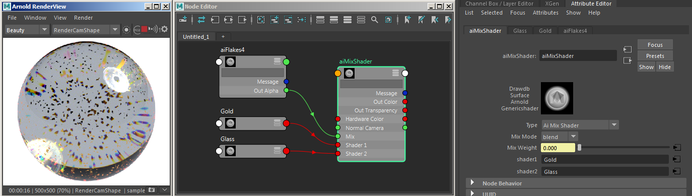

You can also connect the mask (alpha channel) of the flakes shader to a mix_shader to drive different colors for the flakes. For example, you could make the flakes metallic and the other parts glass by mixing them together using a mix_shader.
Mix_shader connected to alpha mask of flakes shader

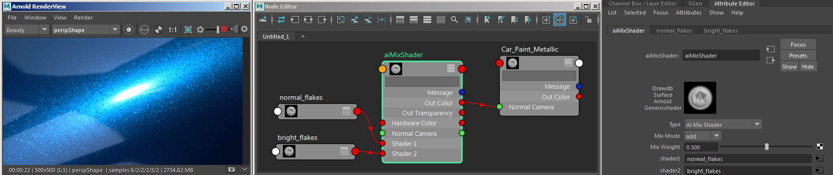

You can use the mix _shader to mix multiple flakes shaders together with different density and normal_randomize values. In the car_paint example below, a second flakes shader has been used to create brighter flakes that are visible around the highlight.
Two different flakes shaders combined together with a mix_shader. Download the shader here
