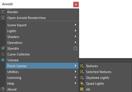

Flushing Caches
The Flush Caches menu can be found within the Arnold menubar in the main application window
If you have Auto-mipmap or Auto-tile options enabled by default, a pre-process of the texture will be performed by OIIO in the first render that a texture is used. This will be saved in the texture cache, and the process will not be required in the following renders. The drawback of this is that in Windows, textures will be locked after the first render.
If you need to modify texture while you are rendering, you have the following options:
  • Use the Flush Caches->Textures command.
  • Disable Auto-mipmap and Auto-tile options while you are modifying textures. With this option, you will not have any preprocess before each render.
Used texture files are locked after a render has been started (even if it is not an IPR session) and they cannot be written by another application such as Photoshop, for example. The typical message that is shown is:
The user then has to close the application and reopen the scene for the Arnold plugin to accept the newly saved texture file. A workaround is to flush the caches.
  • Auto-TX must be disabled as well, otherwise, the .tx texture is used and the original can be modified.
  • This issue only exists on the Windows platform. Linux and MacOS should be unaffected.
  • A short video that shows this workflow can be found here.
Selected Textures
Only flushes the selected textures.

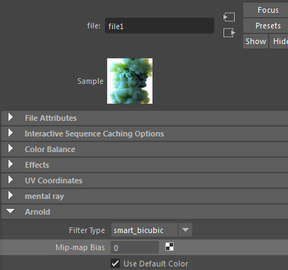

Mip-Mapping Bias
Mip-Mapping Bias offsets the Mip-Map level from which a texture is sampled. Negative values indicate a larger Mip-Map level (bigger texture); a positive value indicates a smaller Mip-Map level (smaller texture). This is evident at the top of the images below:
Diagram showing Mip-Mapping process
The example below shows the effect on a render when increasing the Mip-Mapping bias:

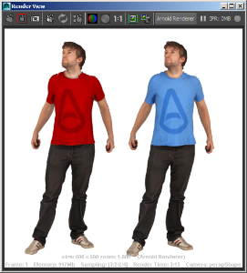

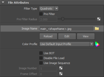

Here's an example shapeName workflow:

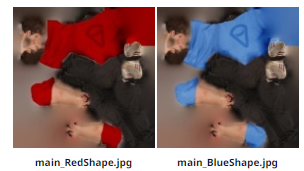

  • Rename the textures to:
  • Add main_<shapename>.jpg to the image name of the file texture that is assigned to both meshes in Maya.
  • Rename the meshes to 'Red' and 'Blue' and the textures will automatically be replaced.
