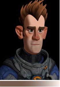

Base Tonemap (ramp)

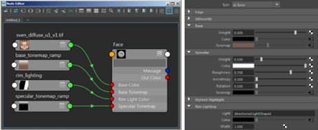

  • Create a ramp similar to the one below and connect it to the base_tonemap of the toon shader assigned to Sven's face.
rampRGB -> base_tonemap

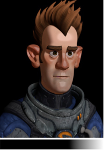

Specular Tonemap (ramp)
  • Lower the specular_weight to around 0.1 and increase the specular_roughness to around 0.7.
  • Create a ramp and connect it to specular_tonemap.
rampRGB -> specular_tonemap

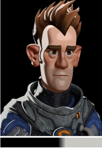

Rim Lighting
  • Create a spot light and position it so that it is pointing at Sven from behind and at an angle. Add it to the Rim Lighting-> Light attribute.
  • Create a rampRGB and connect it to rim_lighting_color.
Light -> rim_lighting
Face Toon shading network

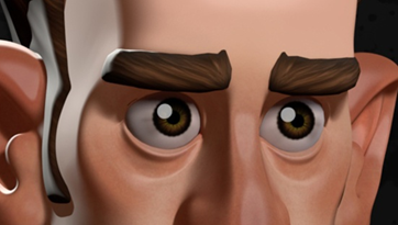

Stylized Highlight

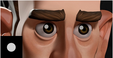

We can use the stylized_highlight to create a cartoon-style highlight on Svens eyes.
  • Create a spotlight and point it at Svens eyes. Hide the light so that it does not illuminate Sven.
  • Connect a circular ramp (similar to the one below) to the stylized_highlight_color of the Eye shader and increase the stylized _highlight_size to around 0.8.
stylised_highlight (specular reflection)
Indirect Specular
Indirect_specular (and indirect_diffuse) can have a subtle effect on the appearance of the toon shading. In this case indirect _specular: 0 works better for the eye shader.
indirect_specular: 0
Eye toon shading network
