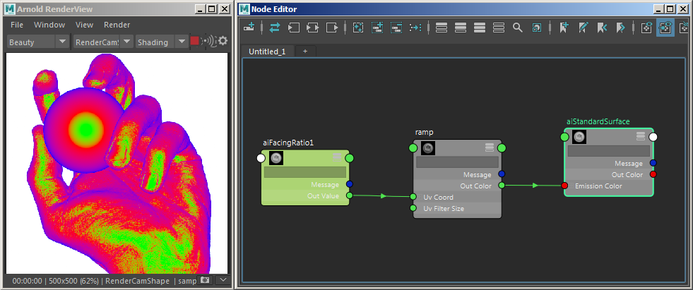

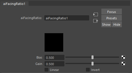

This shader returns the absolute value of the dot product between the shading normal and the incoming ray direction.
Note:
'Heat map' effect using a facing_ratio -> v_coord of ramp_rgb

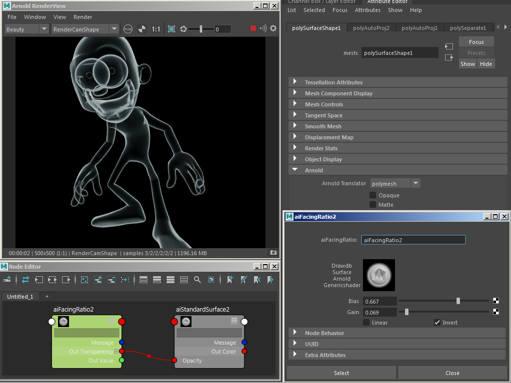

facing ratio -> opacity of standard_surface shader
