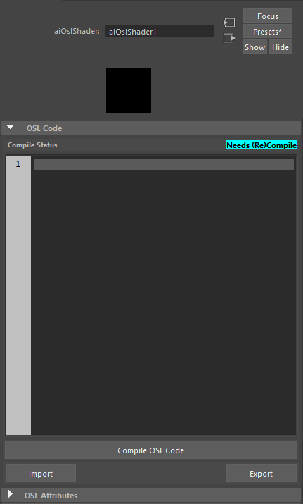

It is possible to create your own shaders using Open Shading Language. OSL shaders can be used to implement anything from simple texture patterns to full materials using closures.

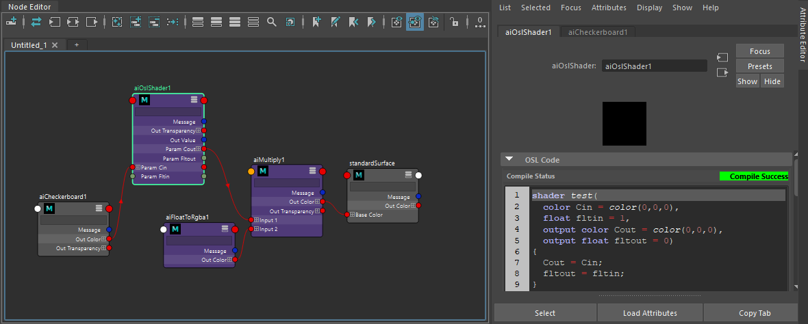

Shader outputs can be linked to inputs of other shader nodes in an .ass file or programmatically via the AiNodeLinkOutput() function by optionally specifying which output is desired when linking. When no output is specified, the node's default output parameter will be chosen, preserving Arnold's existing behavior. Standard OSL language rules apply when specifying multiple OSL shader outputs. An example OSL shader with three color outputs could look like the following snippet and each output could be connected separately:
shader test_shader (output color result = color(1, 1, 1),
                    output color   good = color(0, 0, 1),
                    output color    bad = color(1, 0, 0))
OSL shader using multiple shader outputs
