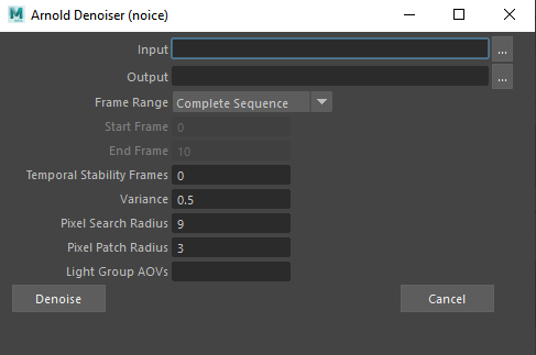

- Go to Arnold> Utilities> Arnold Denoiser (noice) to open the denoising window.
- Choose the rendered EXR image(s) in the Input It should then automatically add an Output path with a '_denoised' suffix.
- Choose whether you want to denoise a single frame or a sequence and then select 'Denoise'. This will start the denoising process based on the settings that you have chosen.

Input
The path to the image or image sequence to be denoised.
Output
Set the denoised output file path. The output file will include the denoised layers with the same names as the original layers. For each file, a new one is saved, postfixed by '_denoised' (the denoised images).
Note that the file output size differs from the input files because only the main RGBA layers are saved (without the auxiliary AOVs).
Frame Range
Choose to render the complete Sequence, a single frame or a frame range (e.g. 1 to 10).
Complete sequence: Denoise all frames of the given image sequence.
Single frame: Denoise only a single frame of the image sequence, specified in Start Frame.
Start/End Frame range: Denoise the given frame range, specified in Start Frame and End Frame.
Start Frame
Set the sequence start value.
End Frame
Set the sequence end value.
Temporal Stability Frames
The number of extra images to be used for temporal stability. Multiple additional frames can be specified to increase temporal stability (for instance render001.exr, render002.exr, render003.exr).
Variance
The strength of the filter is determined by the variance parameter, the higher the variance the more forceful the denoising will be. For variance maybe 0.25 / 0.5 (the default) / 0.75 are good low/min/max values. How aggressive noice is in removing noise can be controlled by setting a variance threshold with the command line argument -variance (-v). The default value is 0.5, higher values will make the denoising more aggressive by considering similar neighborhoods that have bigger color disparities.
| Without denoising | 0.25 | 0.5 (default) |
Pixel Search Radius
This is the area over which similar neighborhoods are found. The higher the better, but it will increase the cost of denoising. For every pixel noice will search a square area with a radius set with the command line argument -searchradius (-sr). The bigger this area the bigger the denoising stability and the higher the chance that similar neighborhoods to be considered will be found. The default value is 9, which gives a 19x19 square neighborhood. Setting it to 21 (a search window of 42 x 42) will look over a pixel area equivalent to loading 5 frames.
| 6 | 9 (default) | 18 |
Pixel Patch Radius
This increases the softness of the denoising (while always preserving the features). The default is 3 (on the big side), but a low value would be maybe 0 or 1, middle 3 and high 5.
For every pixel noice will consider its neighborhood patch and look for other pixels with similar neighborhood patches. The radius of this neighborhood can be controlled with the -patchradius (or -pr) command line argument. The default value is set to 3, which gives a 7x7 square neighborhood.
| Without denoising | 1 | 3 (default) |
Light Group AOVs
Additional light AOVs to be co-denoised can be specified.
Autodetect Threads
Define the number of threads to be used. The default is to leave one thread free, so it should not 'freeze' your computer while denoising.
Denoise
The final step when setting up Denoising. In the log area, you will notice that noice.exe is called for all the files in the selected range.
