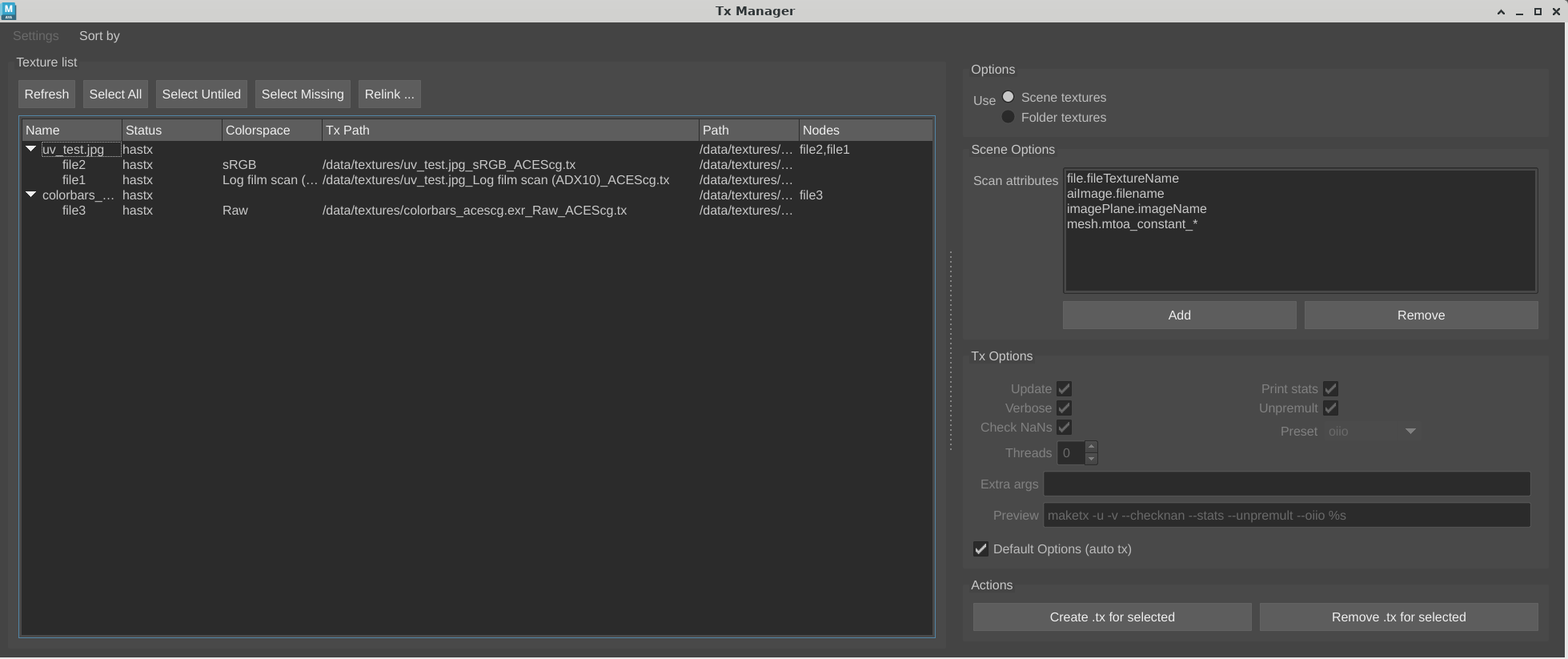

Tx Manager - Arnold for Maya
TX Manager window. Multiple tx files with different color spaces can be generated for the same source file.

Options

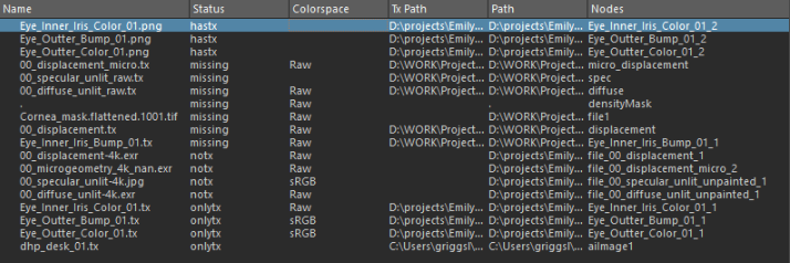

Use Scene Textures
This shows the file textures that exist within the current Maya scene.
- hastx = original and tx exists.
- missing = texture is missing or path is incorrect.
- onlytx = only the .tx file is available.
Click the file pathname to view the texture in the Attribute Editor
Use Folder Textures
Uses the textures files that exist within the 'Textures Folder'.
Scene Options
Set options for finding textures in the current Maya scene.
Scan attributes
A list of node types and attributes to scan for file texture paths.
Add
Add a new node type and attribute to search for in the scene.
Remove
Remove the selected attribute from the list.
TX Options
Enables you to add parameters to the conversion process. The default parameter uses the flags -u (update image) and --oiio (OpenImageIO).
Update
Only update .tx files if there is a new version of the input texture.
Verbose
Show information on the conversion of the texture to .tx.
Check NaNs
Check for and warn for Nan values in the source texture.
Print stats
Print statistics on the output .tx file.
Unpremult
Unpremult the input texture before conversion.
Threads
The number of CPU threads to use for the conversion.
Preset
Choose a pre-defined preset of options, Arnold always adds --oiio to the maketx options.
Extra args
Add any custom arguments that maketx accepts from the maketx options.
Available maketx options
