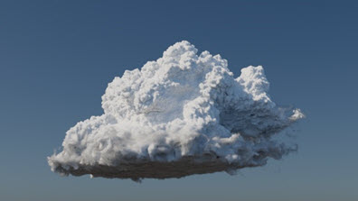

wdas_cloud_sixteenth.vdb. This is the lowest resolution version of the cloud data and so will be quicker to load initially (we will replace it at the end with the full resolution VDB file). - Increase the step_scale to make the volume softer with less scattering. A step size of zero means that the voxel size will be used as the step size. A recommended value for step_scale is between 10 and 20 for this dataset.
| 1 | 20 |

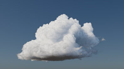

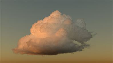

- Connect a physical_sky to the color attribute of a skydome_light. Adjust the elevation and azimuth of the physical_sky to get an interesting lighting effect. Alternatively, you can just rotate the skydome_light in the Y direction.
| Elevation: 45 (default) | Elevation: 10 (sunset) |

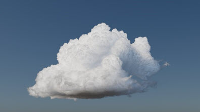

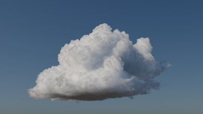

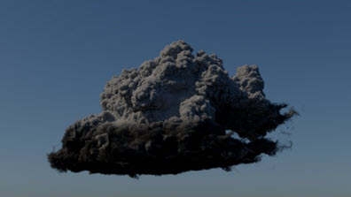

- Before you start rendering the volume, increase the volume_ray_depth in the render settings to a high value like 50 (remember to increase the total_ray_depth to 50). This is key to achieving the realistic cloud look as the light will bounce many times inside the volume, making it appear much brighter.
| 0 (default) | 10 |
| 25 | 50 |

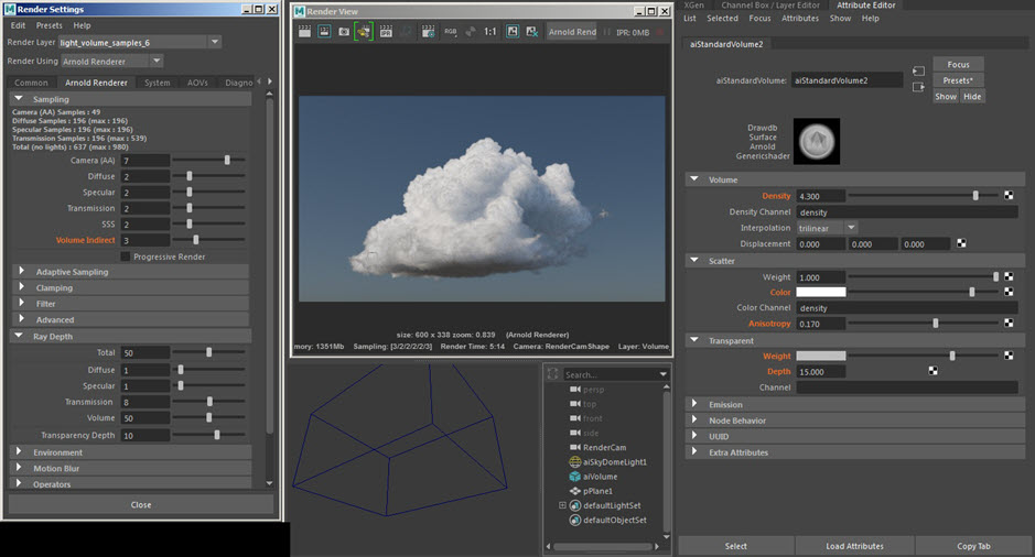

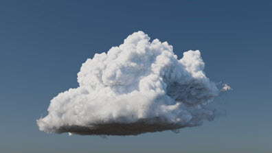

- Create a standard_volume shader and assign it to the volume. The following attributes were adjusted to give the volume the appearance of a cloud.
| scatter_color: 0.5 (default) | 10 |
The scatter slider is maxed to 1. Increasing this value above 1 is a hack and should be used with care. The number should normally be below 1 to be energy conserving.
Remember to add 'density' to the scatter_color_channel.
| transparent_depth: 1. | 15. Controls the depth into the volume at which the transparent_color is realized. |
Increasing this value gives the volume a much more cloud-like appearance.
Transparency_depth is unit-dependent.
| Transparent_weight: 0.368. | 0.7. Increasing this value allows for more control over the density of the cloud volume. |
| Density: 1. | 4.3. Increasing this value gives the cloud volume a thicker appearance. |
| Anisotropy: 1 (default). | 0.5 (anisotropy should be above 0 as clouds are quite strongly forward scattering). |
Color value increased to 10 in color chooser

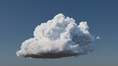

- Replace the VDB file

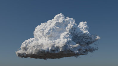

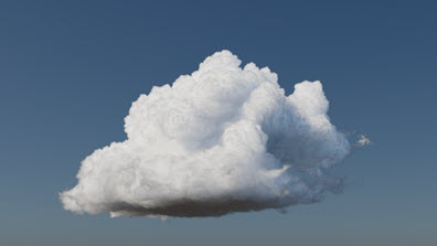

wdas_cloud_sixteenth.vdbwithwdas_cloud.vdb.Bear in mind that this is the full resolution VDB file and so will take longer to render.
| 'wdas_cloud_sixteenth.vdb'. | 'wdas_cloud.vdb' |

Settings used for this scene
